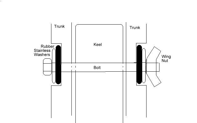

I now have a functional outboard motor for my boat.
Whenever I launch ,should I expect some water to enter the keel bolt location and keel winch tube or are these two locations suppose to be water tight? (I have not yet set the boat in the water)

They are above the waterline, but a little water splashes in depending on conditions. I will be launching out of MDR next weekend to test my new sail, Frank will probably be down there too, put it in the water and see if it floats.

This is how the lock down bolt is configured. It shouldn't leak

I sometimes get water splashing up through my keel winch tube. I keep a piece of sponge (like you use to wash dishes) handy and jam it into the tube whenever water starts splashing through. That takes care of it.

The keel tube is a touchy issue. Too short and it leaks, too long and it is likely to be pulled into the winch which will yank it off of the through hull fitting. Then you really have a leak to worry about.
