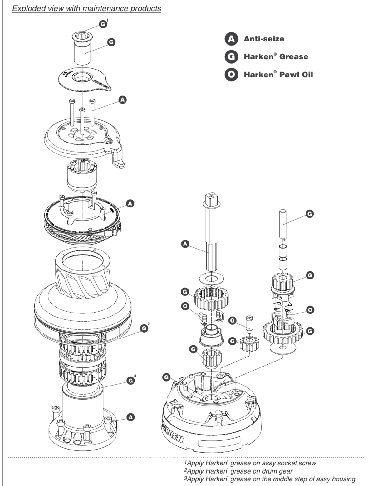

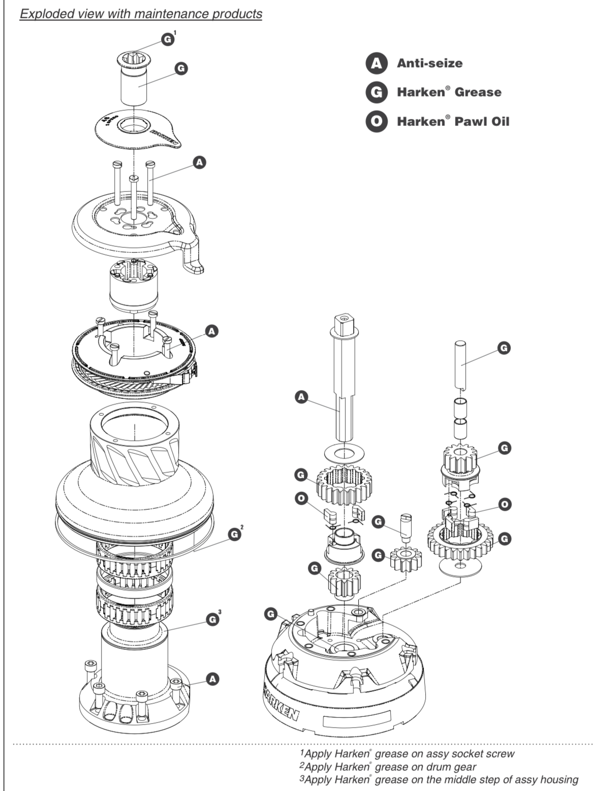

I think you can make a case for just lifting the drum and inspecting/lubing the pawls/springs. Easy to get to, fast, and the most critical, and I think, wear-prone parts (in part because they are only lubed with machine oil). Do that every year. Then do a full cleaning/lube when what you see suggests it.
Unfortunately our Harken 46.2 and 35.2 winches have two sets of pawls, both riding inside inner gears, so it takes pretty much complete disassembly to check them.
Absolutely, quite common, similar 2-speeds on my last boat, and the two speeds on my current boat are similar. However, the condition of the top pawls is still an indicator. That was my point. Perhaps the most common serious winch failures result from either broken springs, sticky pawls, or worn pawl seats. Thus, I pull the tops every spring to decide if they need a complete service. It also seems to be the top pawls that go first. Greater weather exposure?
