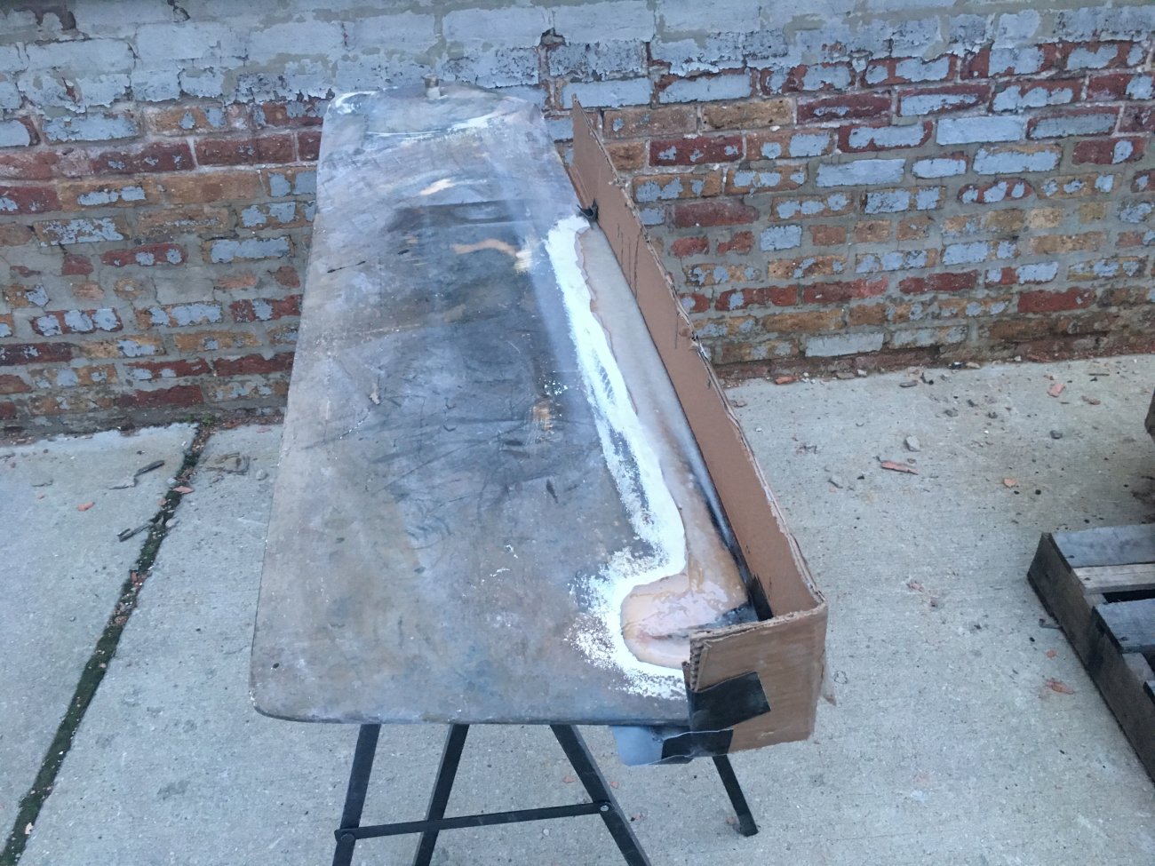

I've been working on a lot of fiberglass right now and it's taking forever for the fiberglass to kick. Today it was in the low to mid 50's. I mixed a medium size batch for the length of my centerboard's leading edge, mixed in some 404 filler and started pouring. An hour and a half later and it doesnt appear as if it's hardened at all. It appears as if a lot of very small bubbles are forming after 30-45 mins. This happened on two separate occasions. I started packing up 1.5-2 hours later and It appeared to be the same viscosity as when I first mixed it. This is the third fiberglass project with this batch of resin. The fist two acted the same but they were hard when I came back the next day. I even used a heatgun on the second project with no noticeable difference.

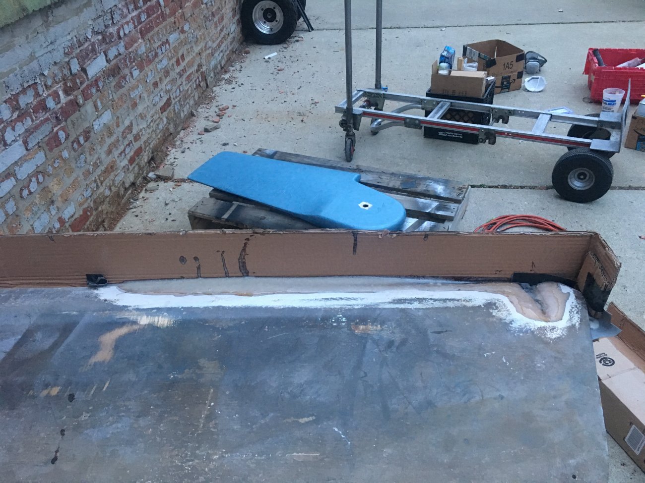

The centerboard was kept indoors until I started working on it last night. I used a large TotalBoat mixing container that's about 4" in diameter. I filled it up about 3-4" (10 pumps). Mixed for 90-120 seconds and then added filler. I layed the resin along the leading edge of the board. I filled a 2-3" wide area that stretched out about 24". It's a large area so it was easy for the heat to dissipate. Because it never really thickened it spread out more than I wanted. I mixed a second batch but suspecting there was a ratio issue I added 6 pumps of hardener and 3.5 pumps of resin. Yes, a bit extreme but it actually started to get warm after 15-20 minutes. As soon as it started to generate heat I dumped a large amount of filler in it and mixed to peanut butter consistency. It probably took me 15-20 minutes to clean up and I don't believe it thickened much before I brought it inside. The resin was purchased about a month ago. Something doesn't seem right. I've seen West resin melt plenty of cups and exotherm like crazy. This stuff barely gets warm. It will gel to the point that it's unworkable but we never see it get hard until we come back a few days later to do some more work

This is the issue. With polyester resins adding more catalyst will speed the cure time, adding more hardener to epoxy will not. What you have is partially cured epoxy and there is not enough epoxy resin to react with the hardener that you mixed with it.

I'm afraid your only option at this point is to remove the bad batch of epoxy. You can try mechanically removing it with a scraper, heating it with a hot air gun may make it easier to remove, it will soften even more at about 150° F. Vinegar or Denatured Alcohol can clean up the residual goo.
