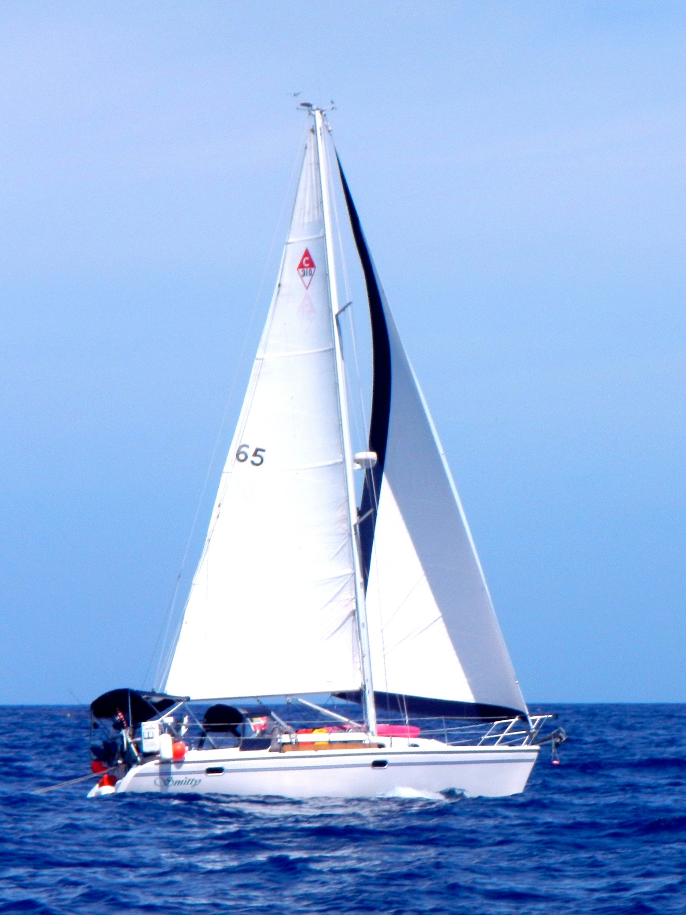

Here is a pic of us under sail from a recent trip to Cat Island in the Bahamas. If you zoom in near the bow you can see the bow rail/life lines pushing the bottom forward edge up over the rail. This is distorting the shape of the sail. It also is very difficult to see around.
This is a factory original sail.

Headsail design is optimized for UPWIND performance. In this regard the will be trimmed in tight. For any expected sail area they will be as tall as possible as opposed to width (high aspect), and as close to the deck as possible. When going upwind, the sail with never touch the lines or rail. Like of the spory-ish new Catalina 275. When cracked off a bit and reaching, absolute sail shape is less important and some sail on the pulpit and lifelines is an acceptable compromise. Any deeper and its spinnaker time!

When reaching, low clew, high-aspect sails like this will twist off terribly when eased. You can see in your picture how much more twist your headsail has vs your main. Those should match. Moving your genny cars forward and then trimming on slightly will often help this a lot. There is not a lot more you can do with a low-clew sail when reaching. Race boats will often switch out to a specialized reaching headsail called a 'jib-top' before going spinnaker.
Thanks for the tip. I will give that a try.

What is hanging off of your bow anchor?

haha. It is a little unsightly. It's a anchor trip line. It is only about 2 feet long with a float. If I ever foul my anchor and need to use a trip line to get it free I only have to dive down to this trip line and pass a line through it. It also helps me spot my anchor when diving on it or checking it with a lookey bucket. Normally it gets put in the anchor locker but we must have forgot on this trip.
