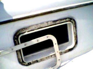

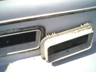

The piece that is screwed into the cabin bulkhead IS the portlight. The outside part is just the trim ring. You can see this clearly in "Hunter Owners Modifications" for the H37C under the "Boat Info" tab at the top of the page. There are two or three portlight replacement projects with pictures. I will add one picture here. And these portlights are available in the store right here on HOW.
