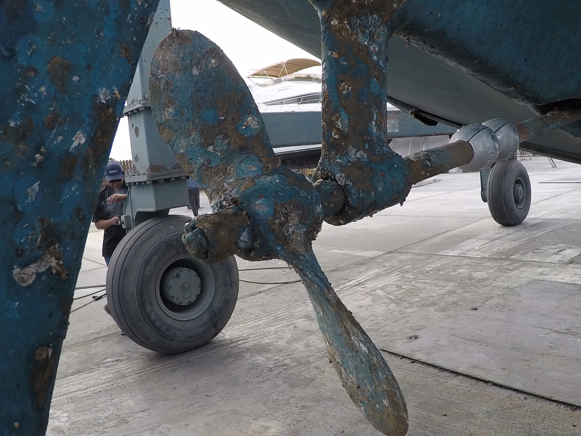

This is what my prop looks like.

Looks like the original prop. Can't see any issues, but that doesn't mean very much.
Good news about your exhaust. Black could mean you are over propped, and white means a blown head gasket.

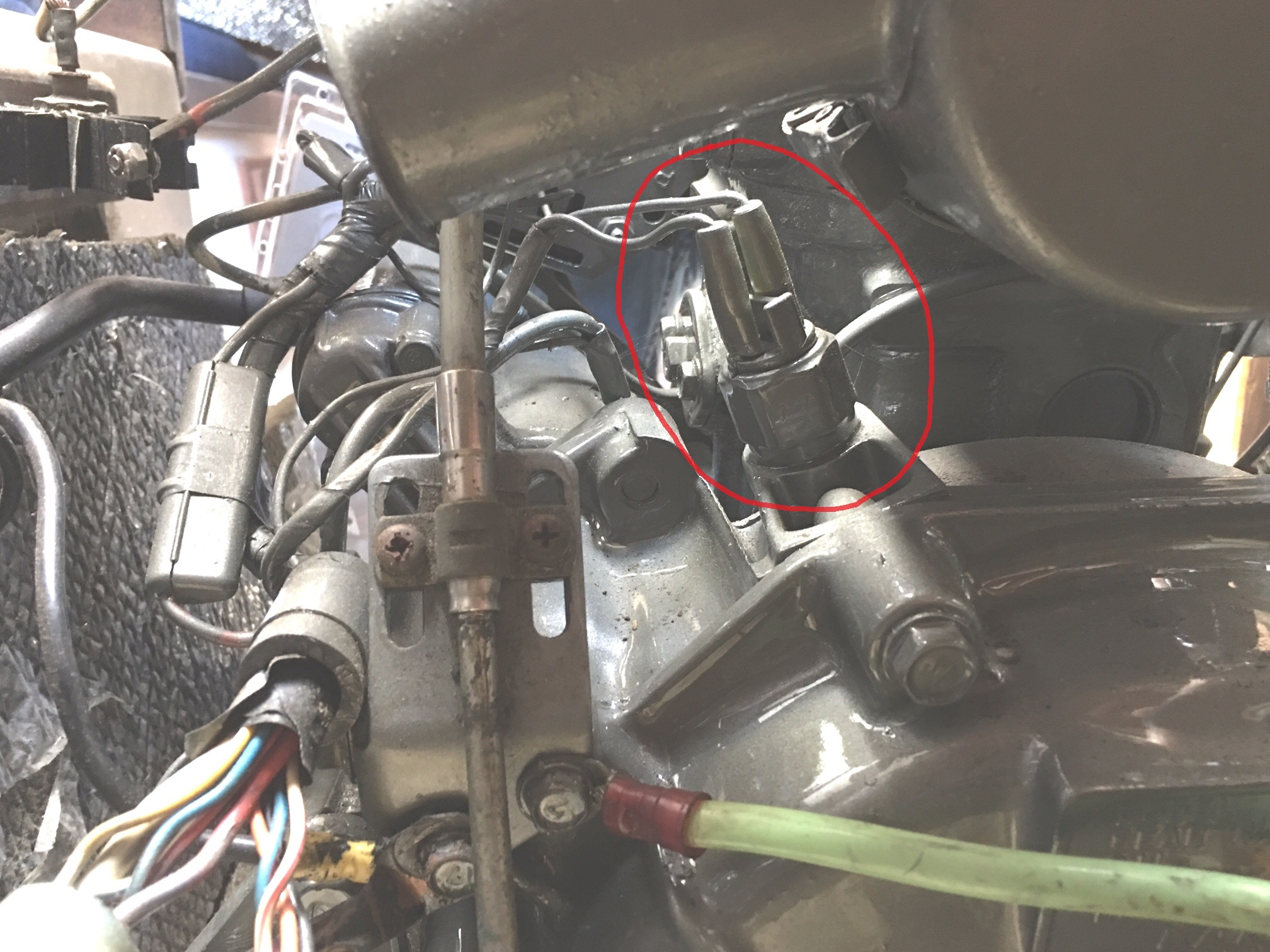

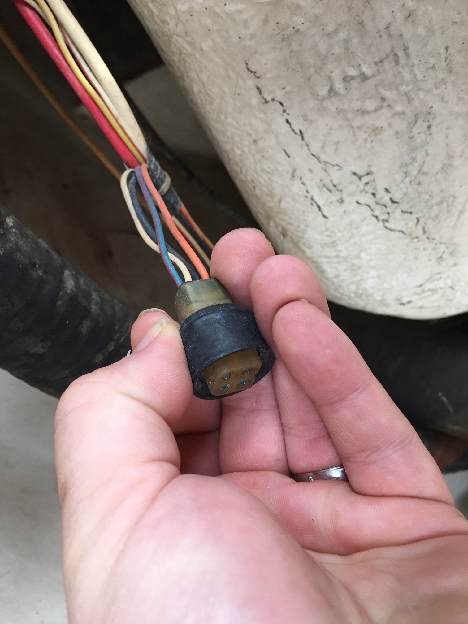

The yanmar manual says that there is a tach sensor on the back of my engine. Its on page 12 or 13. I took a photo and noticed that I have what it describes. There is a orange and blue wire coming out of it. On the other end of the wiring harness there is an unused plug that also has a blue and orange wire. I wonder if this is a simple connection.
