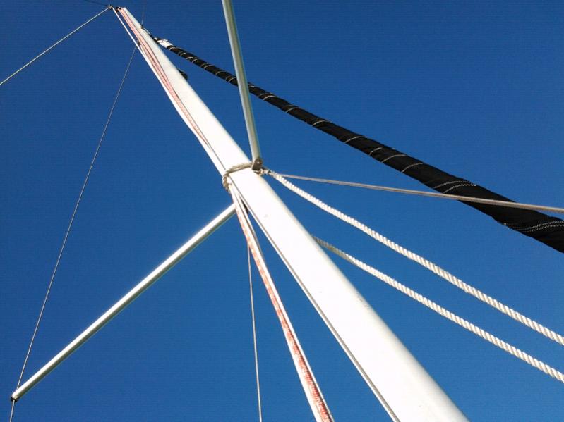

I am curious how long does it take others to step the mast and rig everything up after having things stored for travel? After watching the macgregor video, and seeing it can "be done in ten minutes", and then actually doing it (and it taking nearly an hour) I am curious, and wondering if I'm just that pokey?

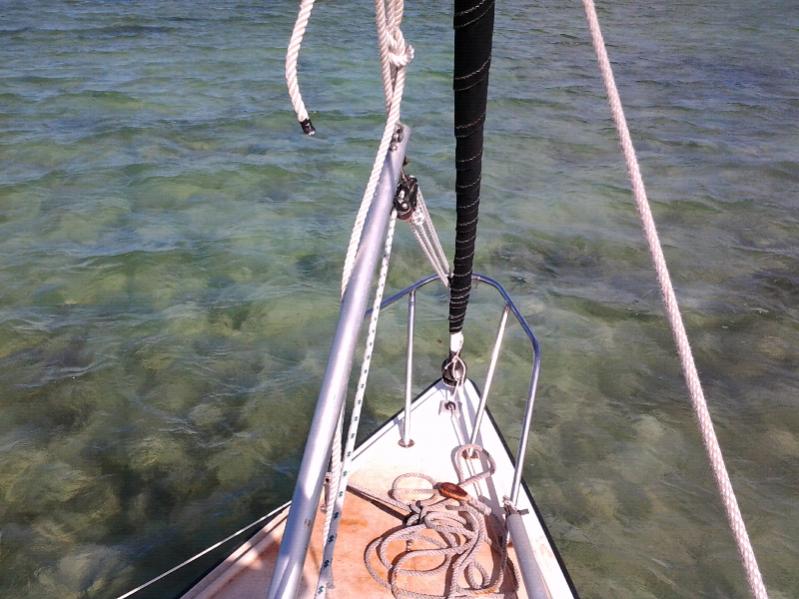

I found a little solution to getting the roller furler attached to the forestay easier...I took a bit of rope, looped it around the furler cup, then made a Foot loop on the lower end, stepped down on it, and brought the furler to the forestay using my body weight instead of struggling with one hand gripping the unit, while the other tries to push the pin through to attach it to the forestay. hope it helps someone who's struggled with this task!
