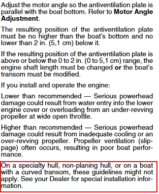

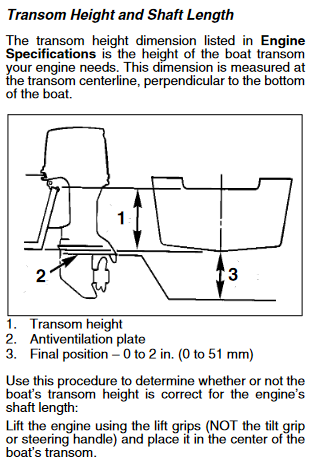

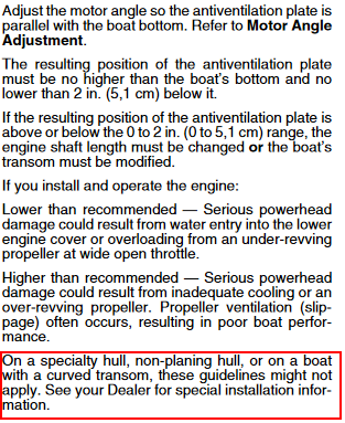

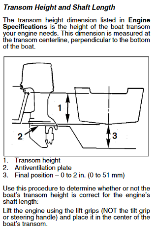

Take a good look at the cowling of the motor. The engineers designed them so that it would be very difficult for the engine to suck up water from an occasional wave. There are drain holes under the cowling and the carburetor intake is designed to keep water out. I would be more concerned about not getting enough cooling water and having the prop over rev when out of the water.
Likes: Parsons
Aug 10, 2020
544
Catalina C25 3559 Rocky Mount
This is correct. Thank you for highlighting that paragraph. I was getting ready to break out a manual to snap a pic.
