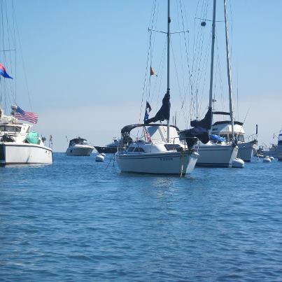

Mine site stern low with the rear gudgeon above water when loaded with two people.
It would sit at the factory boot stripe "if" there were no engine, gas tank and battery.
I have added a coating of epoxy to protect from blistering. That has worked.

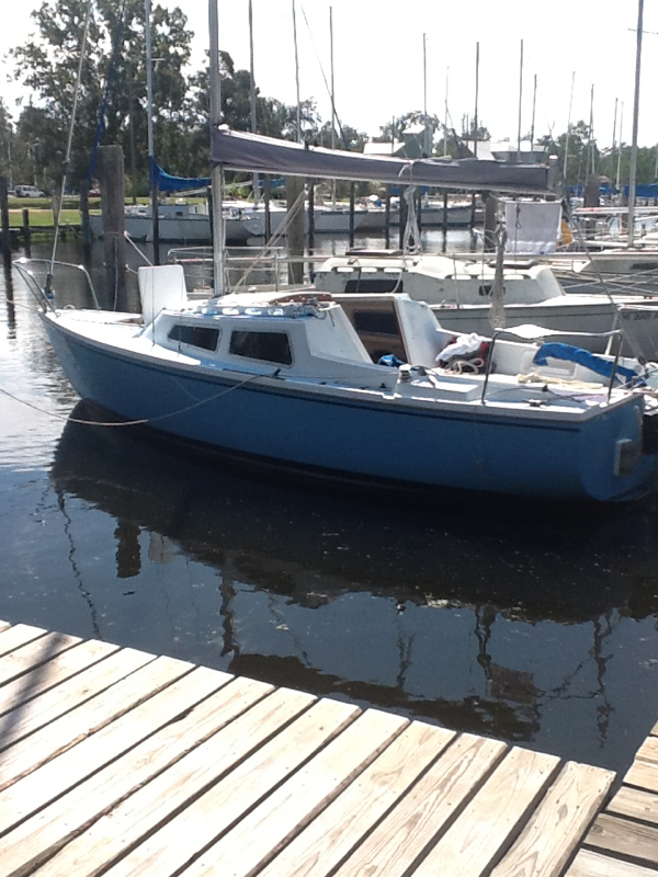

You can see the H20 line on my 1974, but the outboard is down below and very little stuff onboard, no cushions, etc.

Thanks - they appear to sit low in the stern with a battery, OB on the stern, and other junk in the locker. Tends to confirm that there is not likely anything unusual about my boat & I will want to bottom paint up to this year's scrunge line.

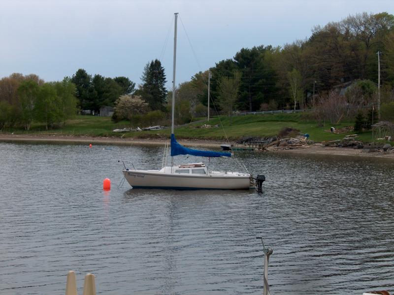

Hey OC
My 83 sits low on her mooring as well. Pretty much the result of 80 lbs of motor cantilevered over the stern. Keeping my anchor in the V berth starboard kinda offsets this a bit though.:D
If you have rail meat try moving them forward when on a reach to a run. Get that wide arsed cat butt out of the water a little and you gain some speed. Just experiment with the fore /aft trimming till it feels right... you'll notice a difference in the boat feel.
Hope the picture uploads.

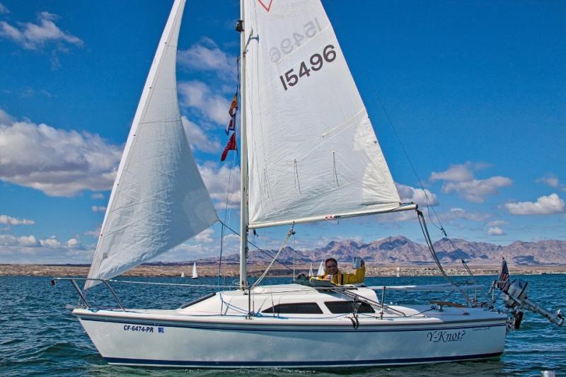

I load an anchor forward and a bit more heavy stuff on the port side to offset the outboard on the starboard quarter. Might rethink the anchor location if we were sailing in the ocean with bigger waves and the weight would make us pitch more.
