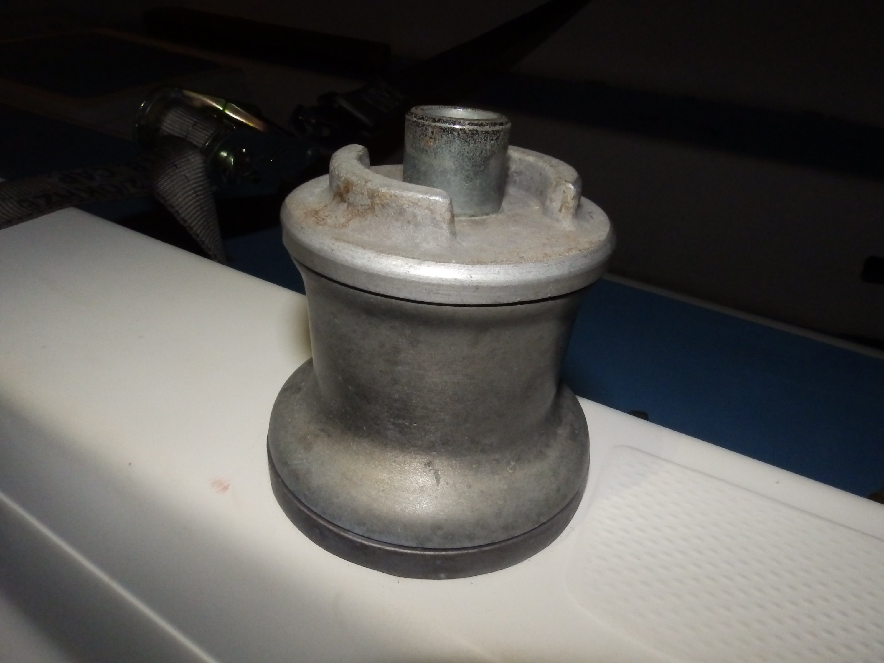

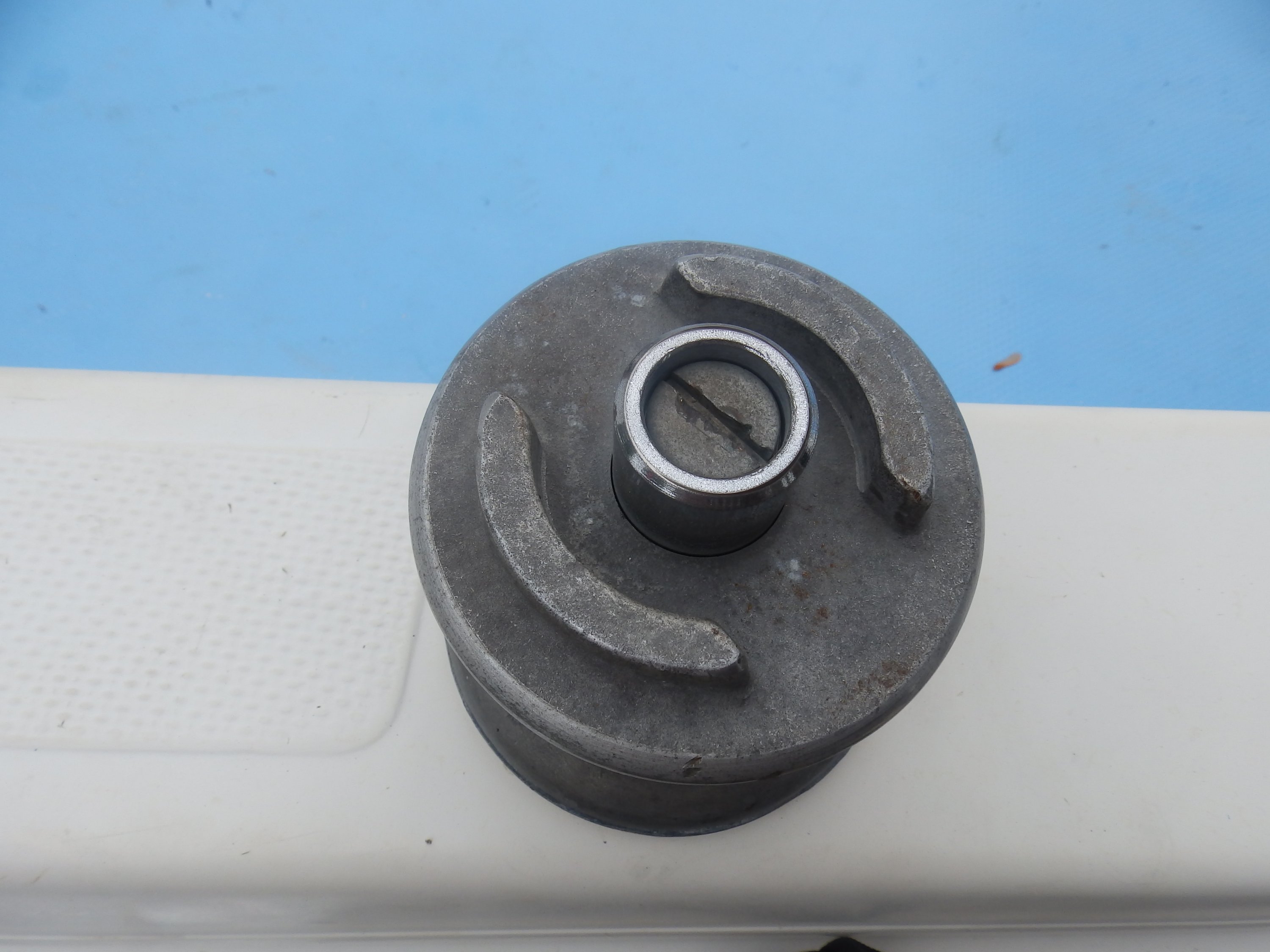

Hoping someone here has seen one of these winches and knows the trick to disassemble them. I only want to take it apart to remove it as am replacing it with a unit that can use a standard handle. I removed the single large common screw that anchors what I think is the pivot for the handle but cannot figure out how to get the top cap and/or drum off so I can remove the screws holding the base to the deck.
Tried prying under the cap and drum to no avail. Left the sledge in the toolbox for now. Don't want to bash the thing to the point it might damage the deck beneath. Hoping some knowledge may be available here to help get this apart/removed without damaging anything else. Pix attached

Someguy - Yeah, that screw comes out easily but still can't get either what I'm calling the cap OR the drum to let go. With that screw out, there's about 3" of emptiness below that I can stick a slim screwdriver in and don't encounter any thing in the way of a fastener that might be removable to release anything.

Not a left-handed screw. Comes out easily with CCW rotation. Cap is female 3/8-24 threaded.
My smallest gear puller is too big to get its jack screw through the 3/8-24 opening but am thinking I might be able to slip a 3" long piece of 5/16 rod through to act as a ram and then use a 3/8-24 bolt in the winch collar threads to drive the ram and hopefully develop enough force to make something give.

Any chance the cap piece screws into place rather than being a press fit? Maybe a couple of taps counter clockwise (or clockwise) on the raised arc pieces would allow it to loosen off?

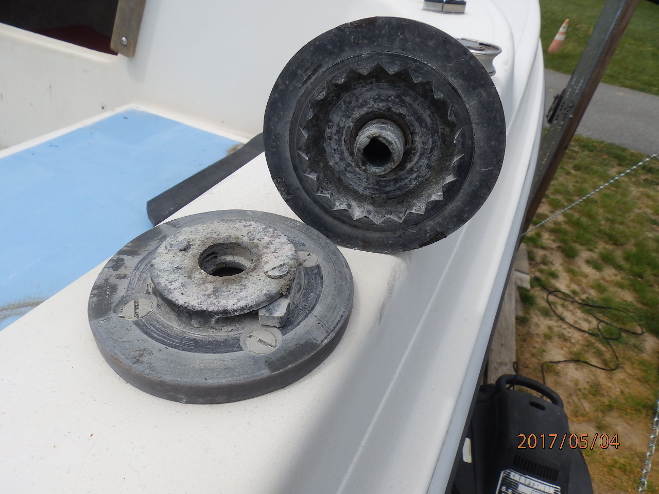

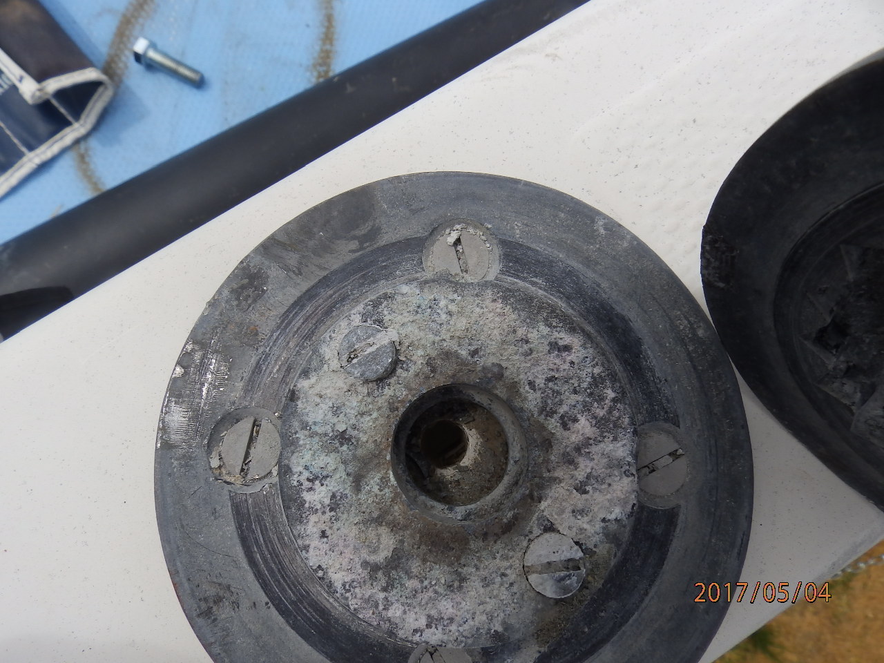

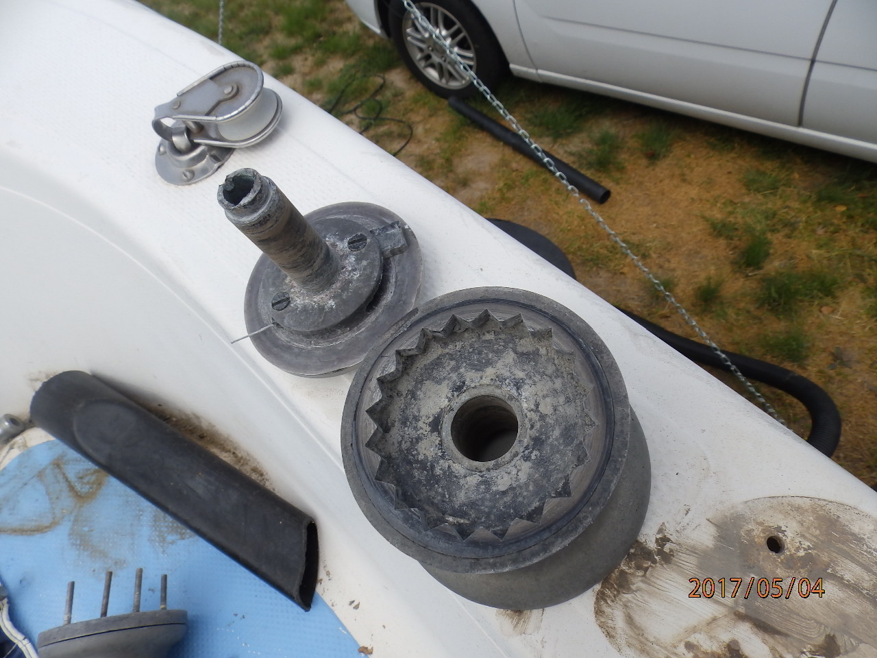

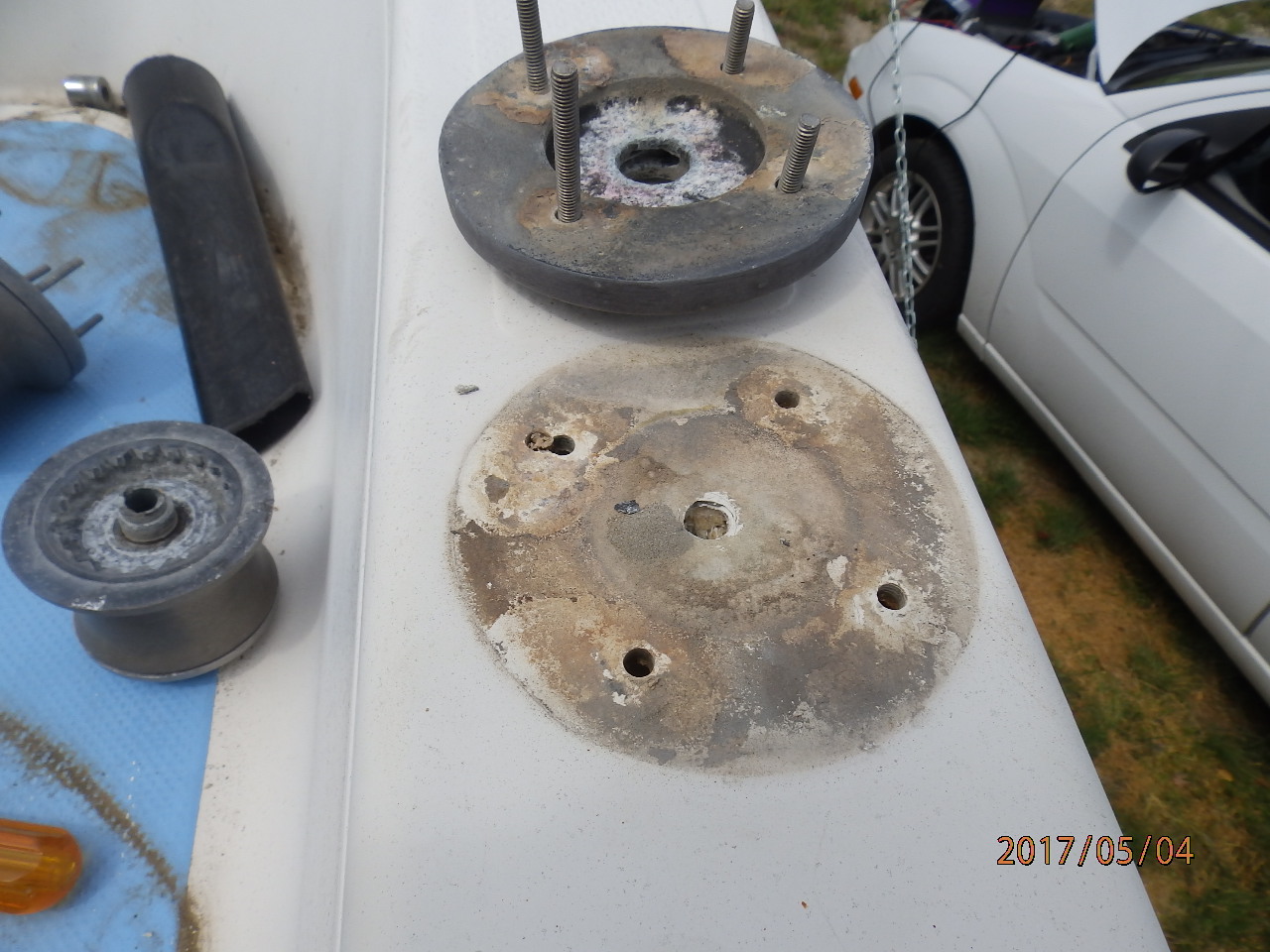

Thanks for all the ideas. Got both winches off today -- removed them from the boat too. For Rob: I don't recommend my ram idea. It did generate enough force to separate the drum from the base BUT in the process, as it turns out the winch base center is not solid, also punched a (nicely centered) hole in the fiberglass underneath. In the end, was able to clamp the tails of the bolts with vise grips and use a flex headed ratcheting box wrench to back off the nuts -- tedious but effective.
Even after I got one of the units apart, I still couldn't figure out how/whether these things were ever intended to be taken apart. Looking at the bottom of the stem I think it was fitted together and staked in place. Never did find any hardware that looked like it was meant for disassembly. Also didn't find anything to ID manufacturer, model etc.

Thanks for taking the pics @EV21
I saved them in my Rhodes 22 folder for future reference
