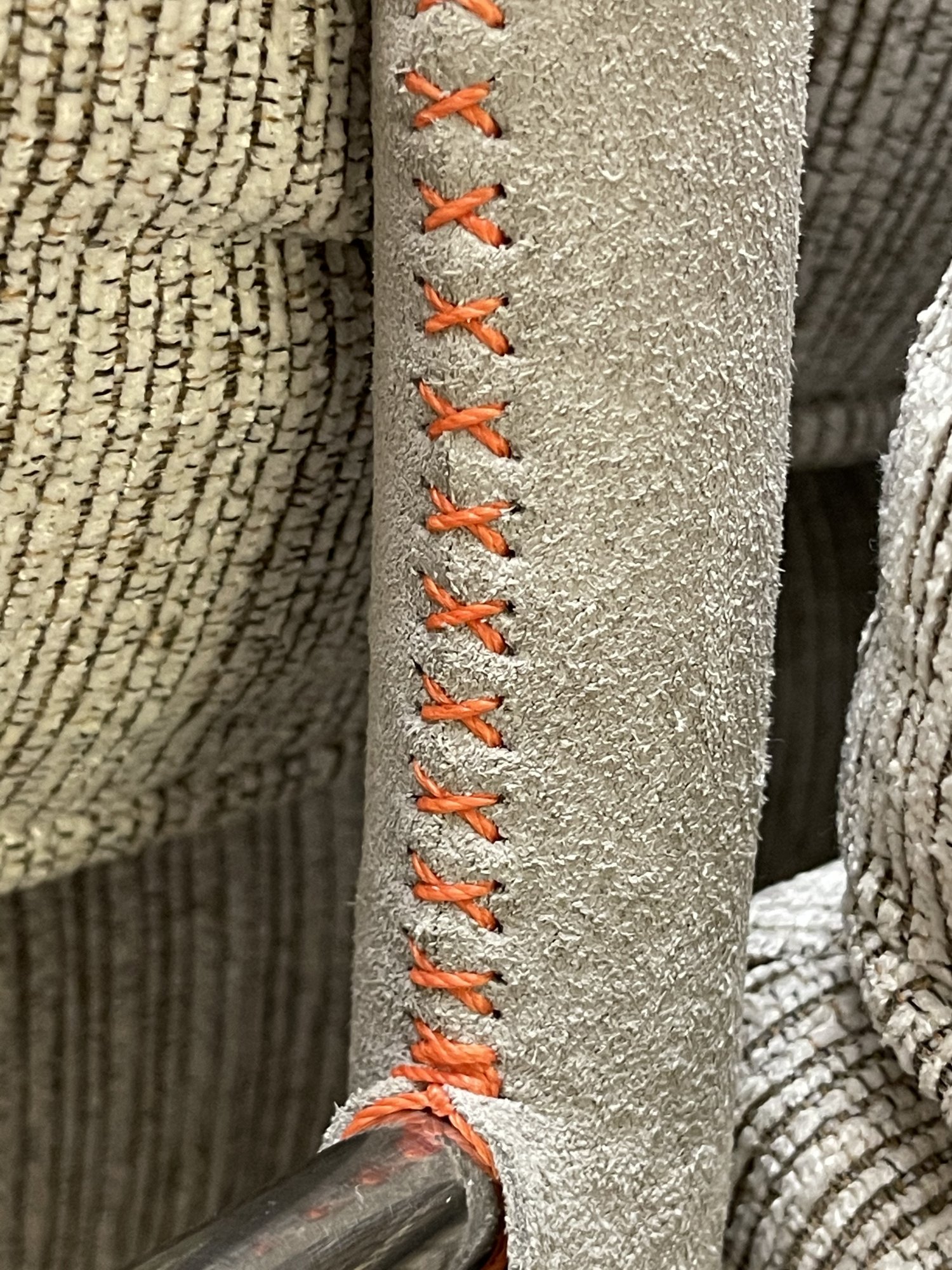

I scrapped the sticky residue with a razor blade. It seemed like it was double-sided tape, with adhesive on both sides of a plastic film. So the Goo Gone couldn’t get underneath the film to release the lower residue.
Using a razor like a potato peeler worked great, then Goo Gone to get the final little bit of residue after shaving all the film and majority of the adhesive.
Although time consuming, stitching the new cover was instantly rewarding.
