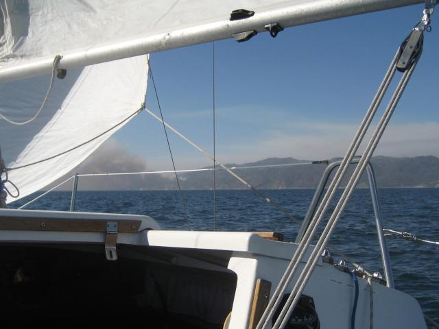

You can see one half of the hasp to the right of the bird on the sliding hatch.
The other half is on the companionway hatch right below the pop-top cover. They work fine for us like this and no plans to change them.

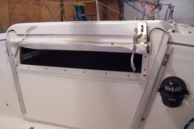

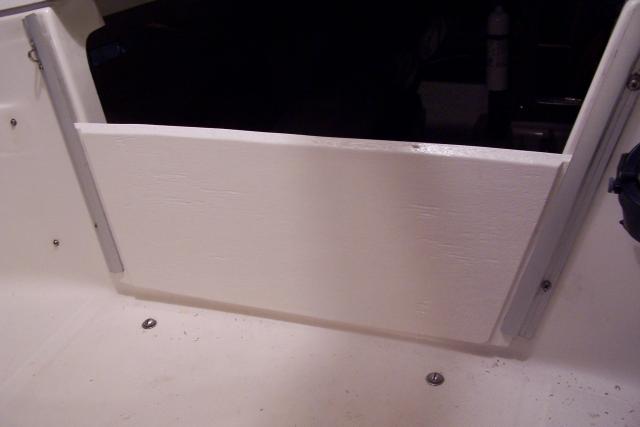

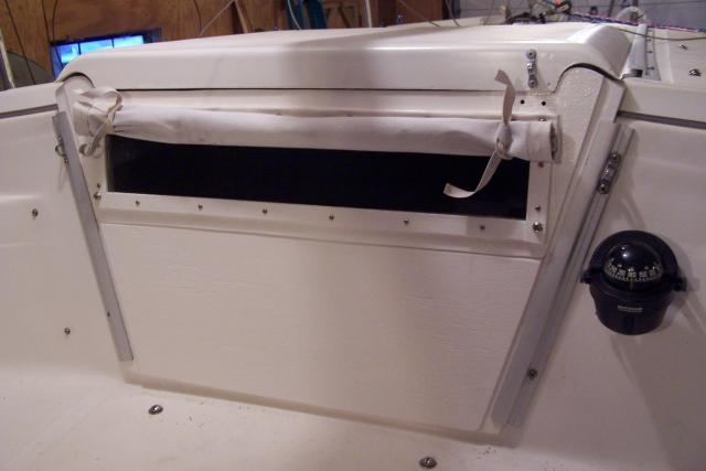

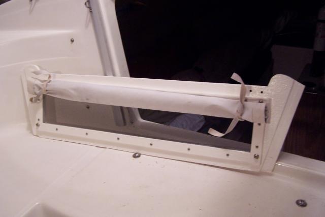

Sum, as you requested, here's a few more pictures of my hatch boards. I made them out of exterior 1/2" ply and dadoed about half the thickness off the edges so they would slide in the aluminum holders. The meeting edges were cut on a 45 degree angle. The opening for the top board was cut out with a handheld jig saw. Metal screen wire was fastened over the cutout with oak strips sealed with clear Boatlife caulk and stainless screws. The flap was made from an old bimini. I backed out the screws after the caulk set, put washers on them, folded the canvas edge under, caulked a bead along the top of the oak strip and put the screws back into their holes this time through the canvas. On the ends I included 2 strips of canvas for ties. I put one stainless snap at each corner bottom corner of the canvas and the male part of the snap screwed into the oak screen moulding on the bottom. Before I put the canvas on I painted the ply with 3 coats of porch and deck polyurethane white gloss from ACE Hardware.

Sum, as you requested, here's a few more pictures of my hatch boards. .............
Thanks. We really like that. If it is cold we leave the pop-top down and having that light come in would be nice. Also do you ever just have the bottom board in by itself for any reason?

We leave the bottom board in only if we're inside and might want more ventilation and the bugs aren't hungry. I was thinking about your comment about Ruth's security if you had to leave her in the boat at a dock or marina. The wing nut idea might work there. The rivets holding the stainless loop on the sliding hatch could be drilled out, #10 screws put in, fastened on really tight with nuts, the phillips heads ground down so no screwdriver could open them and use wing nuts to fasten the loop from the inside. All she would have to do if she needed to leave the boat is unfasten 2 wingnuts on the loop and 2 on the hasp, maybe not even those on the hasp, push the screws through with a nail set or stiff wire to push out the lock. I keep an extra supply of wing nuts onboard in case I lose one. Come to think of it I lost one yesterday.:redface:
I left a step out in the post about building the hatch boards. In the process I left excess height in the top board, then cut the 45 degree angle, put the boards in while I was inside the cabin and used a pencil to trace the shape of the closed sliding hatch against the plywood, then cut it out. That way I got a pretty tight fit to the sliding hatch.

Thanks, I'll consider that. I'm thinking about making it out of just one piece and put in a taller not so wide window (RV type) that would slide and have a screen. Do you see anything negative about that?

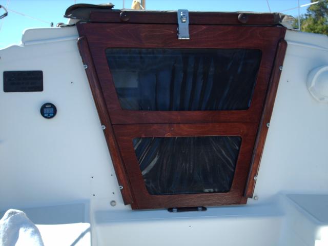

When I made a new companionway door for my Mac25, I used a simple lock to secure the entrance to the boat. If someone really wants to break in, I thought it would make less damage to my boat if its a simple lock. They will simply break the door instead of having to destroy half of my boat to get in ! The original lock was fixed to the plexiglass door with the metal part hanging from the boat's top panel. I used to bang my head into it every time I was going in or out... So for my new door, I fixed the lock on the top and the hanging part is on the door, that way I dont 'scalp' myself anymore:)
There is also a flap made with sunbrella that covers the lock and the gap between the sliding panel and the door.
Here's a pic of the door with the lock in place.

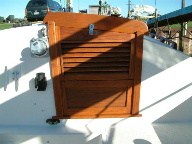

A hatch design that worked well
The picture is from our Matilda 20. There is screening under the louvers plus a thin piece of ply/plastic slides over the opening from the inside.
This has never leaked in any storm we've been in (even with the inside slider open).
I like that you can control ventillation from the inside - actually we almost always left it open and never had mold/smell issues with the boat.
Unfortunately it's beyond my carpententry skills. It was a beautifully crafted hatch from "the old days" - even used copper nails...
