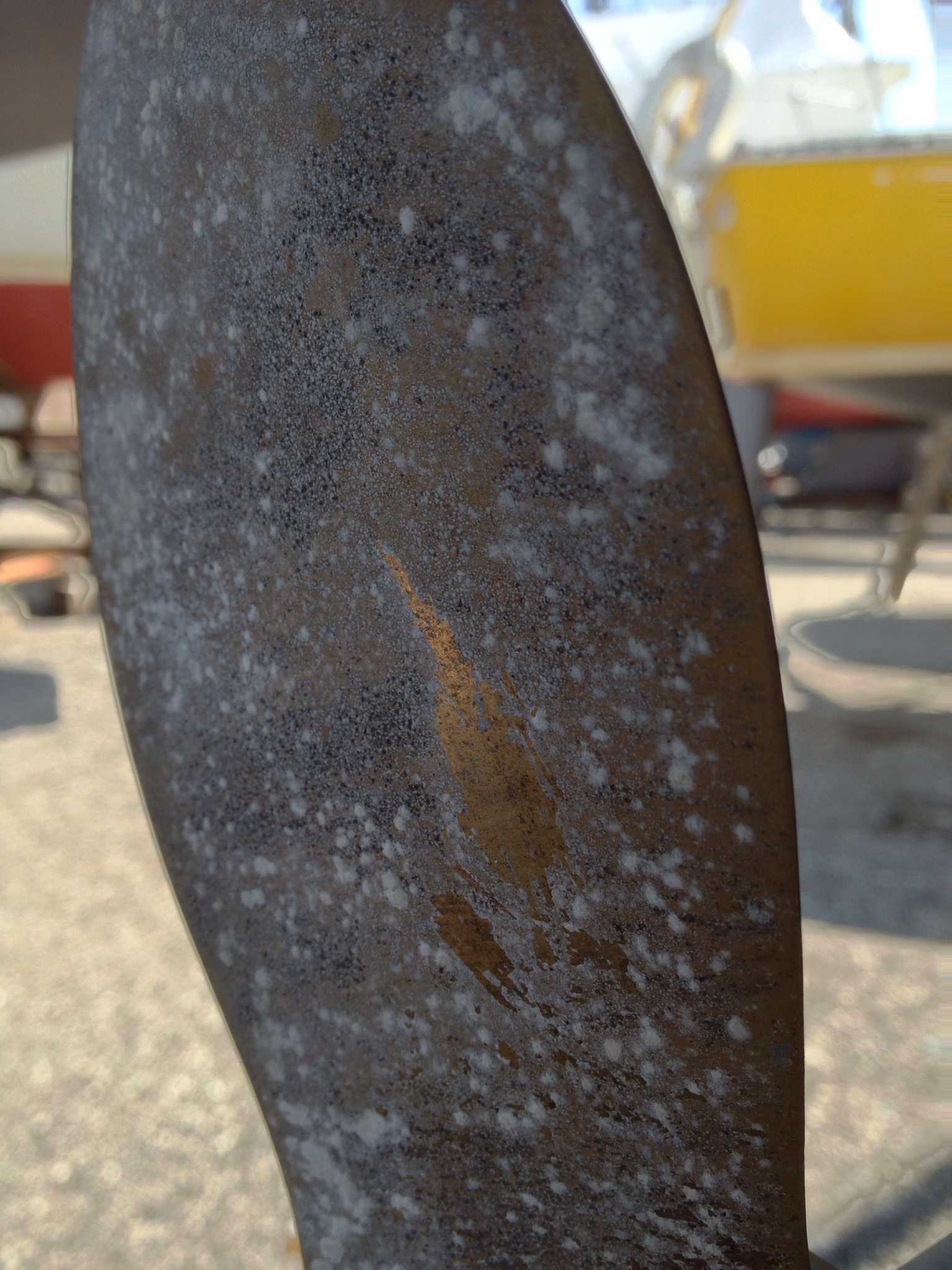

I was at the boat yesterday and took this photo of the prop condition I described in my original post. In previous years without the LanoCote, it came out of the water completed crusted with white scale. That's my fingernail scratch test in the center. Not sure what the black specs are. Don't recall seeing them before.
John's method certainly makes sense. Might be a little more work than smearing on heated LanoCote, but if it works, it's worth the effort.
