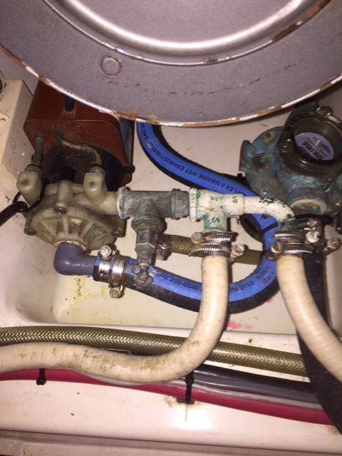

The air purge is the small valve just after the March A/C pump, it purges air above the pump convulute. The two white lines run to my two A/C units and the blue intake line connects to the seawater strainer. Per ABYC there should be a drop from your A/C units back to the pump, down to the strainer and finally the thru-hull. Everything shown here is below the waterline so I rarely need to prime the pump, but if I do it is a 10 second job.

I also have a T Valve between my strainer and the pump. Simply open the thru hull, then the T Valve for a short time and the system is primed. Should be an easy enough install. Here's a picture, look to the bottom left an you'll see the red handled T Valve, it just empties into the bilge. Hope this helps you out.
Likes: All U Get
