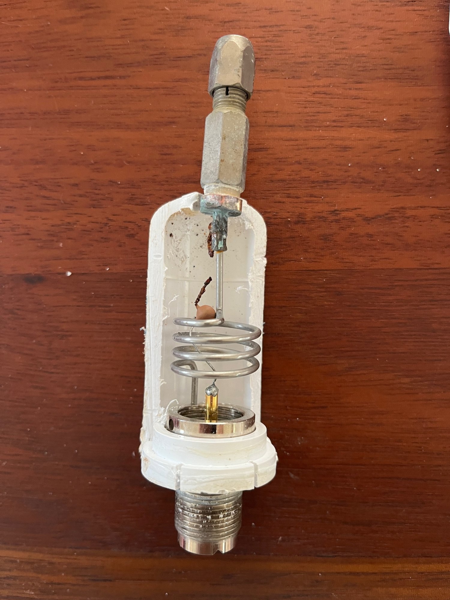

Here is the second Vespar failure. The failure mode is obvious - the center conductor is connected to the coil and whip through a capacitor and the lead on the capacitor corroded off. The Metz was different electrically, as it did not have a capacitor connecting the center conductor. Just the coil. I also think the Metz used the coax shield/mast as a counterpoise, where this one does not.
The Vesper is tuned to 159MHz with a 6db bandwidth to be centered for both VHF and AIS. I suspect this capacitor is part of that tuning.
However, the capacitor and the antenna design is not very robust. The housing is hollow pipe, and while there was no apparent moisture inside (and I removed it in the rain after 4 days of non-stop rain), no doubt normal humidity itself was enough to corrode the fragile capacitor lead.
This was a great antenna while it worked. The center tuning and flat wide bandwidth gave 1:1 VSWR at both VHF16 and AIS. However, I will not be buying another one. This is made easier by the fact that they no longer sell it after the Garmin takeover.

Nice job investigating it. It appears that moisture is leaking in from the top. On your next new one, I would strengthen the top with epoxy. This will make it water proof also. It will not interfere with its performance. It is worth a try.
It is possible that the person who tuned the antenna may have broken the seal at the bottom side by not holding it with a wrench when loosening or tightening the top nut.

There is no tuning this antenna, and nothing to turn. Well, I suppose cutting the wire whip shorter would be a form of tuning it, but it comes shipped all put together, and that is how it was installed.
I also assume moisture got in from the top given where the visual corrosion is, but it was already epoxied into the housing, and that was still good. The weird thing is the iron oxide rust. This is really thick on the capacitor lead, and the solder joint connecting it to the antenna. But there is no iron metal that I can find in it - everything is copper and stainless.
I searched for when I bought this antenna, but can't find anything. It's definitely not 24yrs old. It seems to be a less robust design than all other loaded whips I've owned.

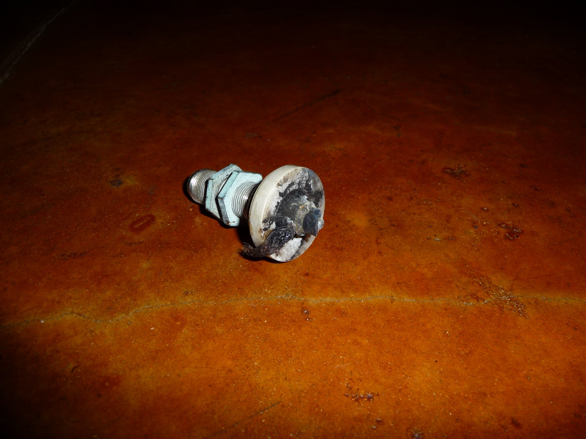

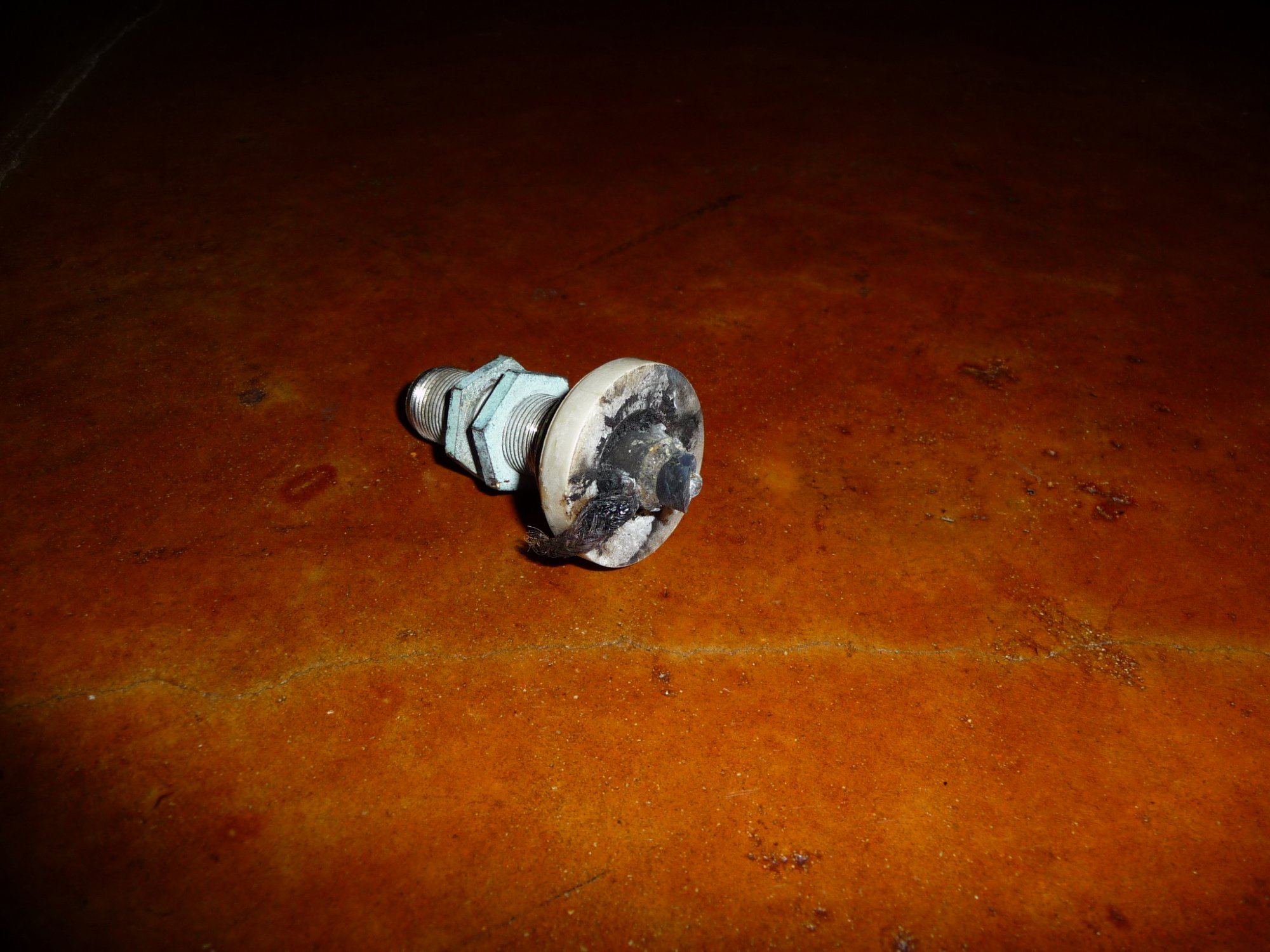

For Reference: Lightning strike failure of a Shakespear VHF base .. I suspect there may have been a little water inside that vaporized quickly..

OK, now that you mentioned lightning strikes, we have had two additional antenna failures that I wasn't counting above. One vaporized completely leaving only some burned and melted stub of coax behind. The other one had its antenna melted down like a candle stick - ending up ~6" long with rivulets of metal running down it and a pool of metal at the bottom. They were mounted together on the mast head one on each side on arms. One obviously took the strike, but a lot of energy went into the other to melt stainless like that. I don't actually know that one failed, as I just tossed it on principle, and the radio it was connected to was a slag pile after anyway.
