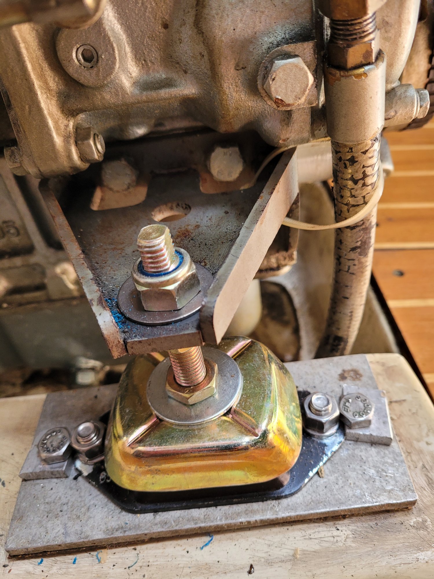

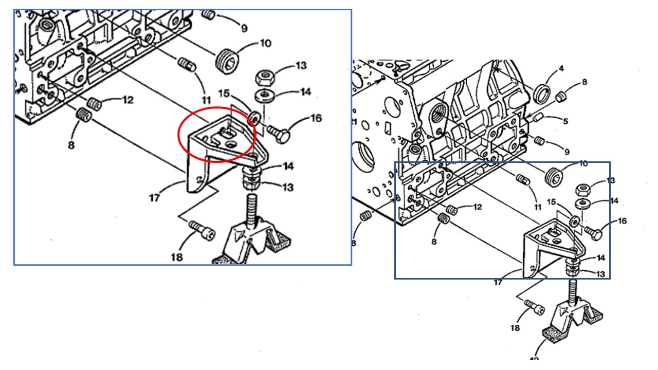

I had a related discussion in the 310 thread, but have a new issue. To reinstall the one bolt, I need to loosen three as there is a slight misalignment and I just can't catch the thread. The bracket is where the motor mounts attach and there are 4 bolts holding it on. The bottom two are flat top socket bolts which sit flush. The top two are standard bolts. Can easily get to the bottom ones with an allen wrench. The top bolts are the problem. The bracket has a cutout where the bolts go and I am guessing there is a special tool for reach up from underneath to tighten them. A 15mm wrench is too small for the bolt but can fit up through the opening while a 17mm wrench will not fit through the opening to get to the bolt head. I similar tried an 11/16 and 5/8 with the same results, although it does appear the 11/16 would fit the head of the bolt if I could get it up there through the opening.
Is there some other kind of wrench that I need?

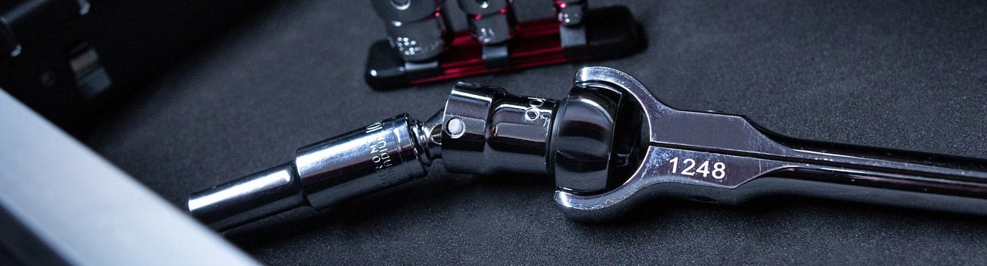

Short socket from 1/4" drive socket set and short swivel extension, then 1/4" to 3/8" adapter and 3/8" wrench.

I was thinking 1/4" drive wobbly bit with a long extension -- reach in from the back where the camera was.
