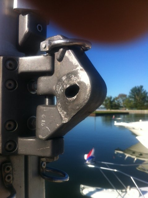

Hi.....as you can see this piece has some ware the hole has taken on a different shape....this boom attachment / gooseneck needs to be replaced as far as I am concerned......where do I get one ???

try the SBO store they sell a lot of hunter parts and i think they are the exclusive dealer for hunter

I would suggest calling the SBO store first. \/ \/ \/

I am with Benny on that one.. Looks like plenty metal for strength.. Drill it round and push in a big bushing.. an "engineered" plastic like PEEK or Delrin.. a plastics place may have a piece of scrap that you could use.. BUT if ya can't make it yourself, the $50 price for the new one from Phil is a deal!

yes for 50 bucks its a done deal...ordered!......
I will do as suggested with the old one and put a bushing in it....
