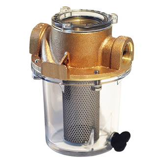

Good question. Most in line strainers have screens in them. Which strainers (picture please) are you thinking about.
For example the Groco
Groco, Bronze Raw Water Strainers with Monel Baskets, ARG Series.
  • Select by Port Size = Size
  • Thread is NPT
  • Monel strainer basket with 2 mm holes
  • O-Rings on all mating surfaces
  • Screw-on cap makes for easy maintenance
  • One-Piece Molded Sight Glass Eliminates Tie Rods and Gaskets
  • Non-Metallic Cap Magnifies Internal Viewing
  • Improved Drain Plug
  • Mounting hardware and brackets included

You would size the raw water strainer to that same 3/4" pipe size. Manufacturers then size the strainer filter media dimensions to meet pipe size flow rates.

twodzusfittings... I have a Groco ARG-750 3/4" similar to the picture in tssailem's post mounted on the wood panel between the port side of the engine and the space under the galley sink.
