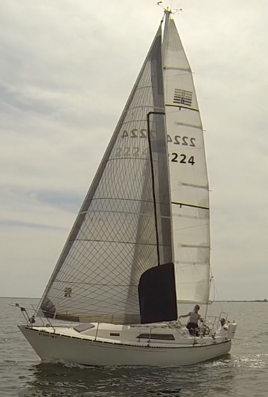

Another downside of a sewn on UV cover is that it can contribute to premature material breakdown near the leech. The sewn on UV cover adds stiffness/support to the leech. The area of the sail just forward of where the leech cover ends is more flexible and acts like a hinge that over time will cause the sail material to fail because the sail is constantly flexing at that point every time the sail luffs like when you tack. Here is a photo of my friend's headsail that has failed because of the sewn on UV cover. You can see the area that's been repaired with a black vertical material near the forward edge of the cover.
