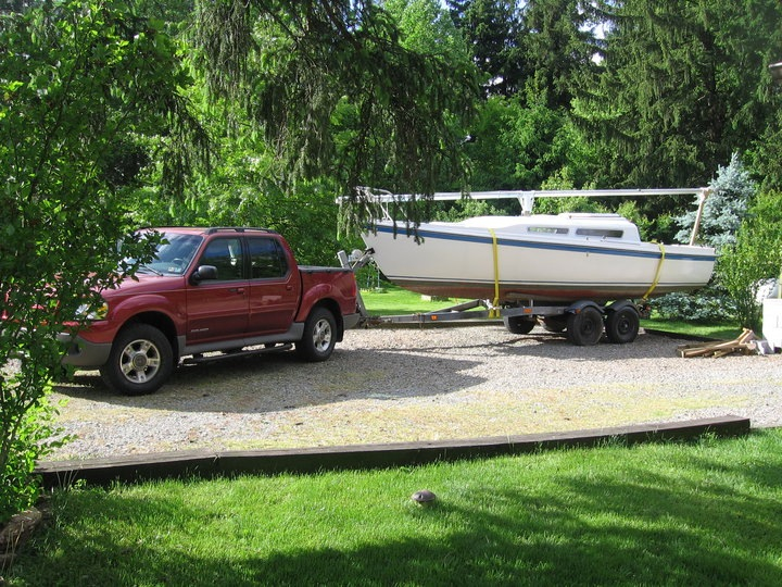

Hello doehunter
I have a 1990 26d Which is very close to the same as the S and for a tie down strap I actually used a 3 in wide cargo ratchet strap across the beam of the boat right behind the main hatch. I put carpet scraps and foam scraps under the straps to avoid wear on the paint. and I attached the strap ends to the trailer.
great set up easy and fast and 3 in cargo straps are found in any hardware store. cheap and secure
I trailered my boat 300 + miles with this never a bounce off the trailer

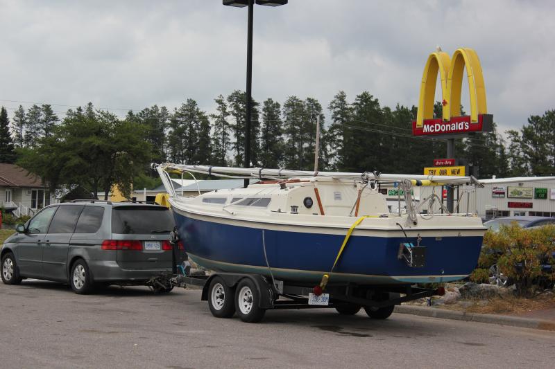

Stern Tie-Down
I also use a ratchet strap but I run it behind the rear deck cleats. This has the effect of holding the boat down and pulling it toward the front of the trailer. After loading the boat I tighten up the strap before giving it the "Macgregor bump" and I find that it helps moving the boat forward to the front stop on the trailer. Once the boat has slid forward I retighten the strap.

I use a 3" strap too but I have it across the bow by the hatch. I think if you don't have the bow firm on either the Y or a bow support, you should. The boat likes to bounce when you hit uneven spots such as on and off bridges. I never see any flutter of the strap like the little ones. I think I got my strap at advance auto parts but surely they have some at harbor freight or northern tool.
