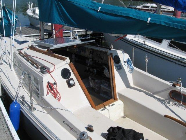

Info-
40w solar panel
Genasun 4 controller
2-6v 235ah batteries in series
No generator or alternator
No shore power
Location; central Ohio
Incandescent cabin lights
Nav lights
Depth sounder, knot meter
Steaming light
Stereo
Fan
12v wet/dry vac
12v TV
17v at the panel, 13.2v at the battery. Rarely, do I draw it down to under 12.6v. Granted, I havent had a long spell of cloudy days since I installed the panel, so conditions have been pretty ideal for solar. Just wondering if not taking the batteries down to 50% occasionally, and charging with a charger is doing any damage to them.
