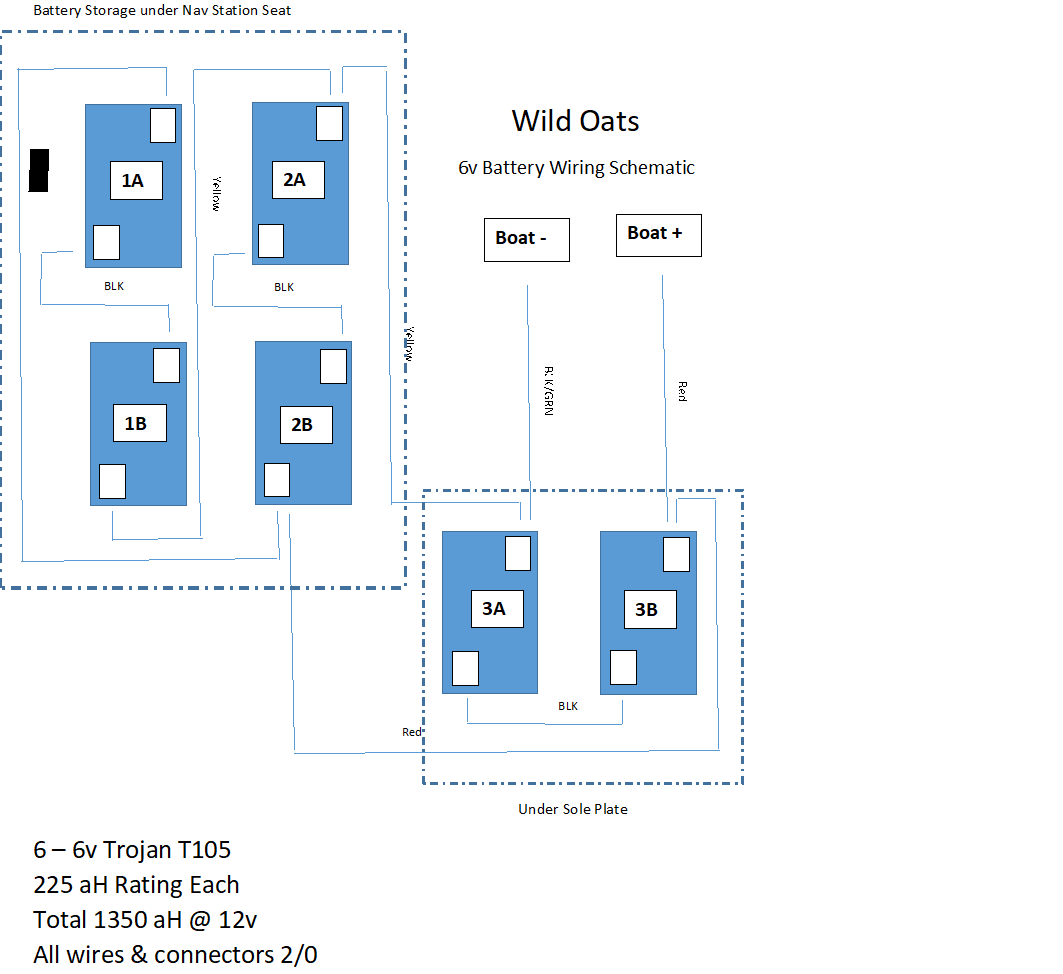

That sounds good, how do you wire the T105's, could you send a photo so I could see what type of jumpers I would need to make?

TH here you go. Hope this helps. The first is the original battery. the second is 2 sets of two where the originals went. There is another set of two under the sole plate (last pic). Making a total of 6 batteries in the full bank. The third is a wiring diagram of how I wired it with wire sizes. Ignore the total Ah reading that is not correct.
