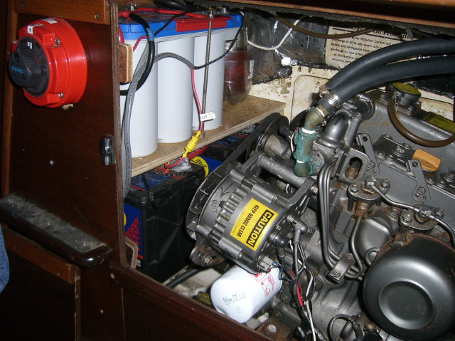

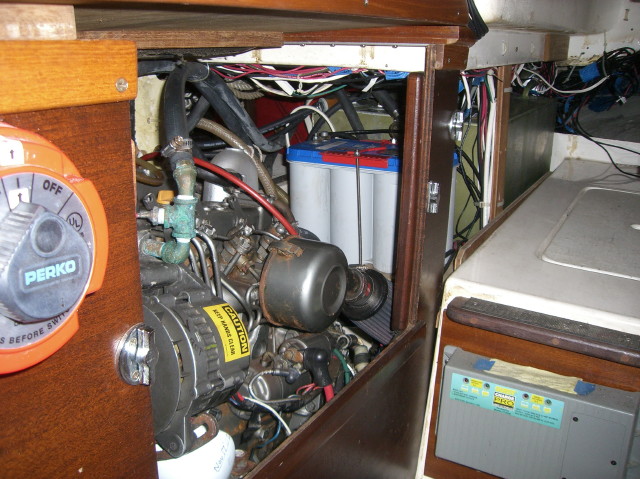

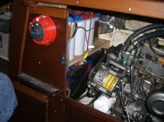

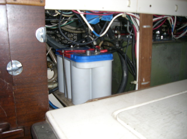

I have a pair of 24's as engine bank on a shelf I mounted just above the shower sump forward of the engine. Just anough space to get my hand in to beat on the shower sump pump. My 3GM 30 misses the batteries by about 3/4". The house bank is two group 27 AGM's. I made another shelf just above the engine bank that holds a group 27 AGM transverse along with the coolant overflow can and a few other odds and ends. The second half of that bank is on another shelf I put in just aft of the engine goilng across the engine compartment. That second battery sits just forward of the fuel tank. Short cable runs and I don't loose any stowage space. If it matters I probably have pictures, although I think I have posted them here before. Ask if you need to see them.

Sam, Thanks I would really like to see them. I have rewired the whole boat and am now ready to install the batteries. I don't want to use up my storage space in the cabin. And yes Rich they are T105's.

I found the pictures. It gets a bit snug in there but I can get to things if I need to. The fuel tank is visible because my woodwork is set up to be quickly removable for easy access.
