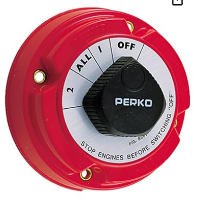

We still don't know what kind of switches you have. Right now, I'm assuming that you have ON-OFF switches for both the start battery and house bank with an emergency switch to combine both banks. This was shown as the 3rd option in Stu's post. (Others are perhaps assuming you have the ubiquitous 1+2+B switch).
