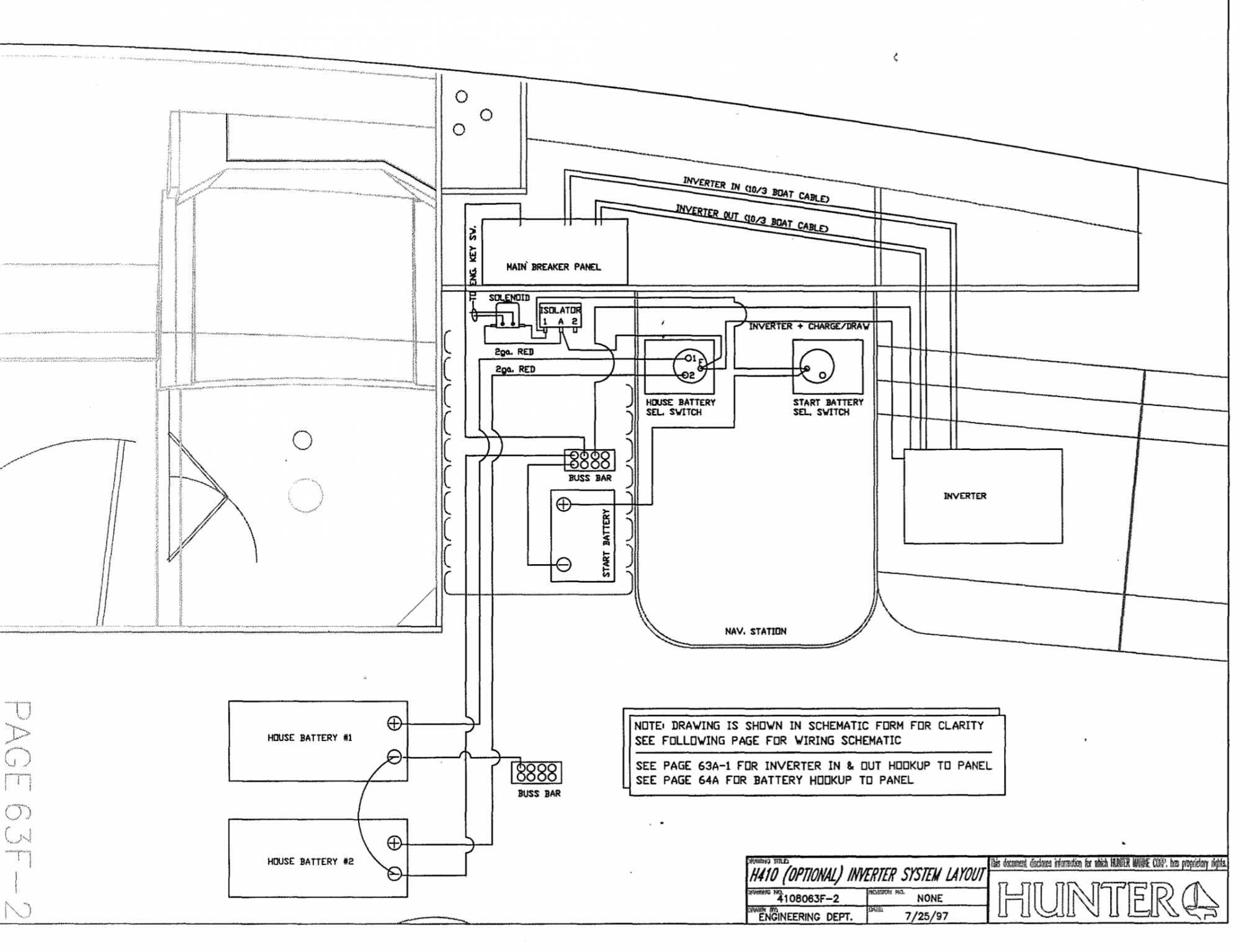

ok i found this in H410 Owner's Manual
Note page # on the left.
Others can chime in to help you.
Jim...
The alternator isn’t in the picture, so it’s a little hard to tell what’s actually charging the batteries when the engine is running. Best I can tell though is that when the engine key is on the solenoid parallels the house and start banks, so they should both have the same voltage when the engine is running. The OP doesn’t see the same voltage on both banks, so either:
  • The solenoid failed
  • The house battery select switch is set to off
  • This boat isn’t wired as the diagram shows
  • I’m misinterpreting the diagram

David, you are correct.
My guess is his ignition key to operate the solenoid does not work, thus engine alternator is only charging the Start Battery.
It will never charge the House Batteriess. When had similar issues, i carry a pair of jumper cables to connect
Start Batts to house batteries to charge them from the Alternator.

I guess it could be the key too, but in many boats the key also controls other things like the alternator field, electric fuel pump, and oil pressure alarm. If the H410 requires the key for any of those things it would be apparent it’s not working, whereas the solenoid could fail more silently.

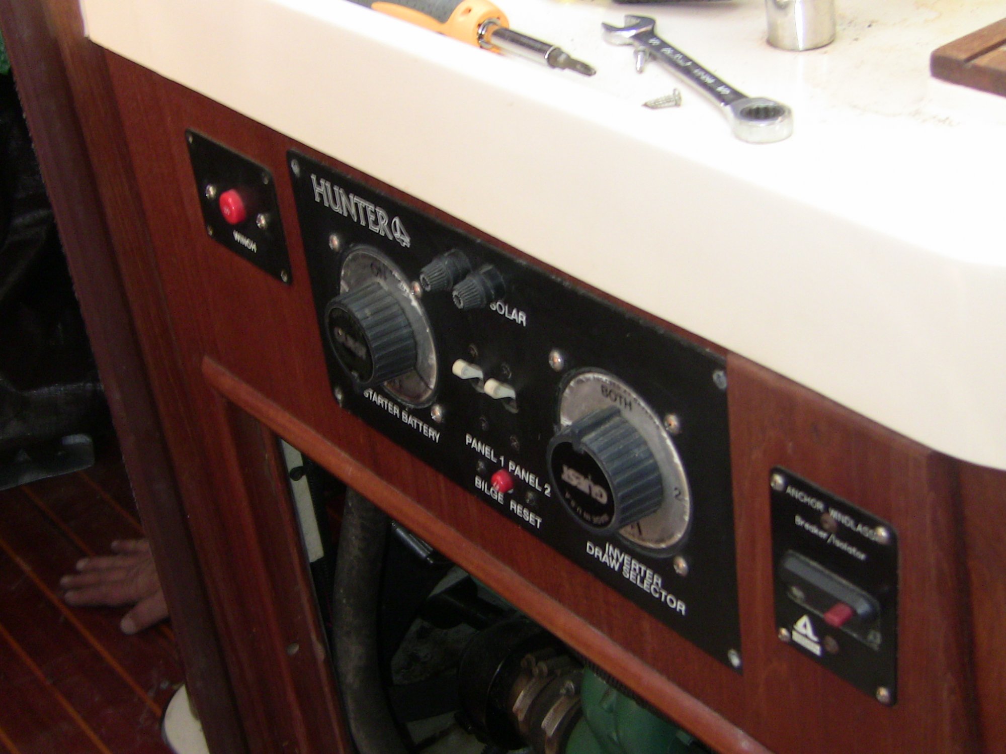

I'm seeking out simpler solutions first so I'm going to make sure I understand how the charge relay system works from the alternator. I'm relatively certain I need new batteries either way, but to someone's point earlier, it seems to me that when the engine is on the voltage should still be going up over 13 volts.
The reason I suspect the batteries have been drawn down numerous times is because while I was in the long process of buying her, the selector switches were left in all sorts of crazy positions and combinations without folks seeming to know how to work them. From my reading in the manual, the inverter draw selector acts like a 1/2/Both switch when the inverter remote switch is off. So leaving it in the off position while on shore power means they are getting no charge. I found the switches that way many times upon returning to the boat.

I have a 410, had that same problem. Its the battery solenoid if only your start battery is charging. Its behind the panel underneath your navigation desk where the main breaker for the anchor windlass is. Cheap easy fix. The solenoid is not connecting the house battery once its started and running.
