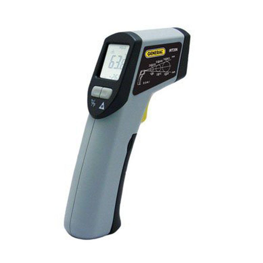

Have you seen these infrared temp gauges. You can point it at a hose and get a temp reading .
Box store, Costco, Amazon, even Harbor Freight sell them $35-$50. I use it all the time on the boat to give me an indication of how systems are working.
Point it at the engine to get a base line temp. Point it at the WH coolant hose connection on the engine. Should read nearly the same temp as the engine. You know the coolant is getting heated. Point it at the WH coolant input. Is it the same or different from your engine reading. Point it at the WH coolant out connection. You should see a little difference. Not much. Point it at the connections in and out of the Heat Exchanger. Then check the temp of the coolant return to the tank. If you get funny readings anywhere along the way that is where you start your inspection.
If the Coolant "Heating" part of the system is good then your next step is to check the supply line connections to your sink faucets. It is a process of elimination. The temp gauge just saves you the time and work of disconnecting all of your hoses, lines and fittings to find your problem.
