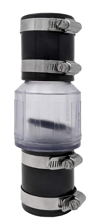

There should also be a check valve
Tips on CHECK VALVES:
1) Flapper type or Ball type [in line orientation important]
2) Double Clamp connections.
3) Function tested each season.
______
The Water Heater "Relief Valve" is a Check Valve :cool:
________
Visual of a Big FLAPPER type.
