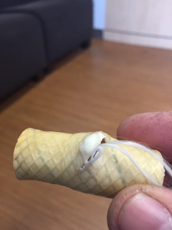

I turned on my hot water heater yesterday (110V) and about an hour or so later the output hose burst at the connection to the heater.
The hose was very hot and very soft at that moment. There was plenty of hose to just snip off the bad end and re-connect it, and I have no idea if the hose was already compromised, but should I consider changing out the whole thing? I have no idea how old it is. Here's a pic of the part I cut out.

Those particular hoses, which Catalina used on many of its boats of our and your vintage, tend to get stiff and hard as they age. Wish I could. :)
Replacing the PRV is a good idea, since it should have blown before your hose. Easy to find at a hardware store, take your old one with you.

Thanks, it didn't even occur to me that the PRV didn't open!! I'll be looking into that first thing. Those hoses are hard when they're cold but are very soft and flexible when there's hot water in them. (opposite of what you wanted! :) )

This type of hose should not be used on a hot water heater that can be heated off an engine. Most of these hoses are max rated at around 150F and many engines run at 180-190F.... Do the math.....;)
The engine is what likely melted it and the electric side just finished it off. On a boat you should never be able to develop enough pressure to blow the T&P on a Seaward water heater as the stock T&P is 150PSI and the POS PVC hose would have failed long before that point if the engine has the heater up to temp, or previously has and softened it. This hose is usually rated at 150PSI but that is at 70F.... Take the hose to 180F and it can easily burst at just 40PSI.
