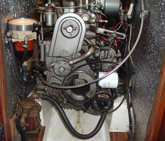

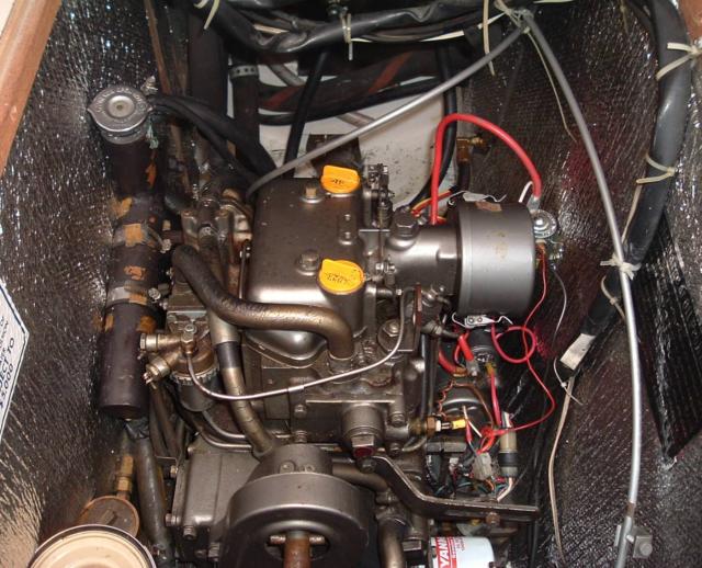

My original 2QM20 had been converted, I think at the factory. Besides the heat exchanger you will need the pump, a way to mount it, and the longer belt.
Mine just had a piece of one-inch angle iron bolted to the block and then the pump bolted to that. You can find the heat exchanger online. Pump too.
In the pictures you can see the heat exchanger with water fill on top left. I had started to remove the pump in the second picture thus the piece of angle just hanging there.
10,229
Ahh Haa.. Thanks for the post, Ed !! On my buddy's boat, the hot water tank is in place of the little jumper hose just in front of the closest yellow oil cap in Ed's picture .. The hose comes from that right side hose fitting, goes through the hot water heat exchanger, then back to the front of the exhaust manifold hose fitting where the little jumper terminates.. If ya want to do the hot water without the engine heat exchanger, that is how you'd hook it up..
