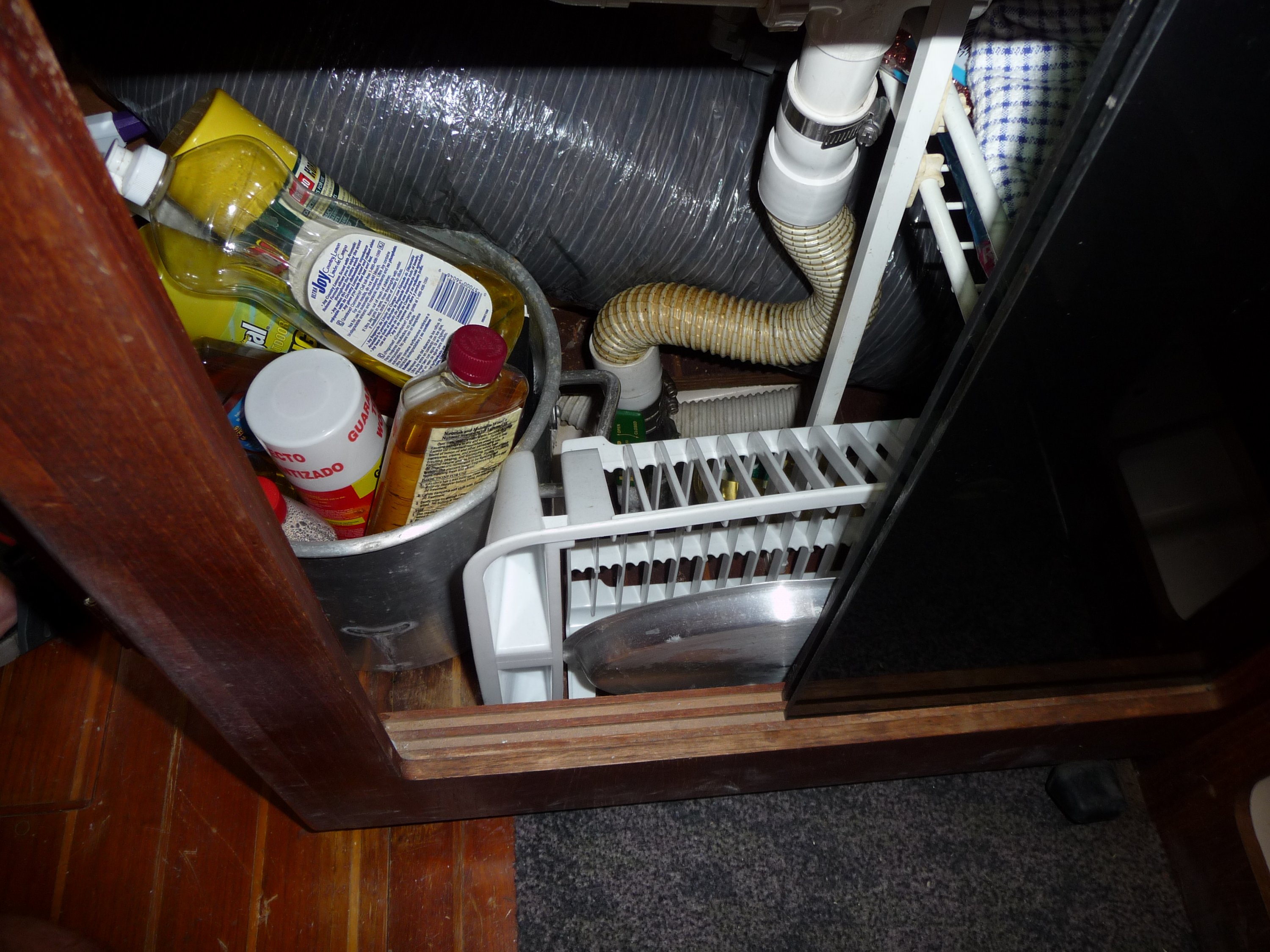

SFS, the hoses look like this.. a soft collar on a spiral wound hose.. cuff seals on the hose barb..(kinda center of picture) If ya don't have them, you are good ! They can be replaced with the correct size, smooth bore, "sanitary hose" from Depot/Lowes.. Allan is right on !

Ah, spiral equals "ribbed' or corrugated. Unfortunately, I have those, but they will be replaced soon. And I will go to Depot, and buy what they sell as "spa hose". Pricey, but not as much as sanitation hose at West Marine.
