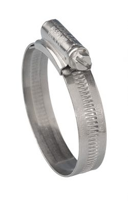

I understand it's preferred we use those hose clip/clamp that has solid threads and not this with holes for threads on board. Searching internet, I'm not able to find those solid threaded hose clips. Perhaps I uses wrong description in search. Anyone any idea what the the solid threaded hose clip is called?

available here many places
I like the product. Use them for hose clamps on my boat.

Was going to suggest this site, but as others noted, they’re out of stock. I bought a couple last fall from my local West Marine store. Defender and Jamestown Distributors also carry them. Search for Solid Band Hose Clamps, 316 Stainless Steel.
