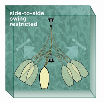

I thought this was what your were talking about.
From Anchoring 201 "The hammerlock moor (figure 4) is a technique that’s hard to beat if your boat is horsing about in gusty winds. It consists of dropping a secondary anchor on short scope beneath the boat’s bow – the primary anchor continues to take the brunt of the load, but the boat’s horsing will be dampened by the secondary, which also reduces ground tackle strain considerably. During substantial wind changes, this secondary anchor will likely drag to a new position relative to the wind shift. Relax. It’s all part of the master plan of drudging, the intentional dragging of an anchor. Once settled in the new position, it’ll continue to operate as before."
Figure4

I saw that. It's the "version" of the H-moor where the anchor is dropped directly underfoot instead of at a maximum point of sheer.

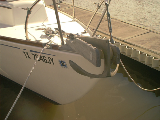

Funny that the illustration shows perhaps the worst type of anchor to use. A Bruce, for example, is much better.
