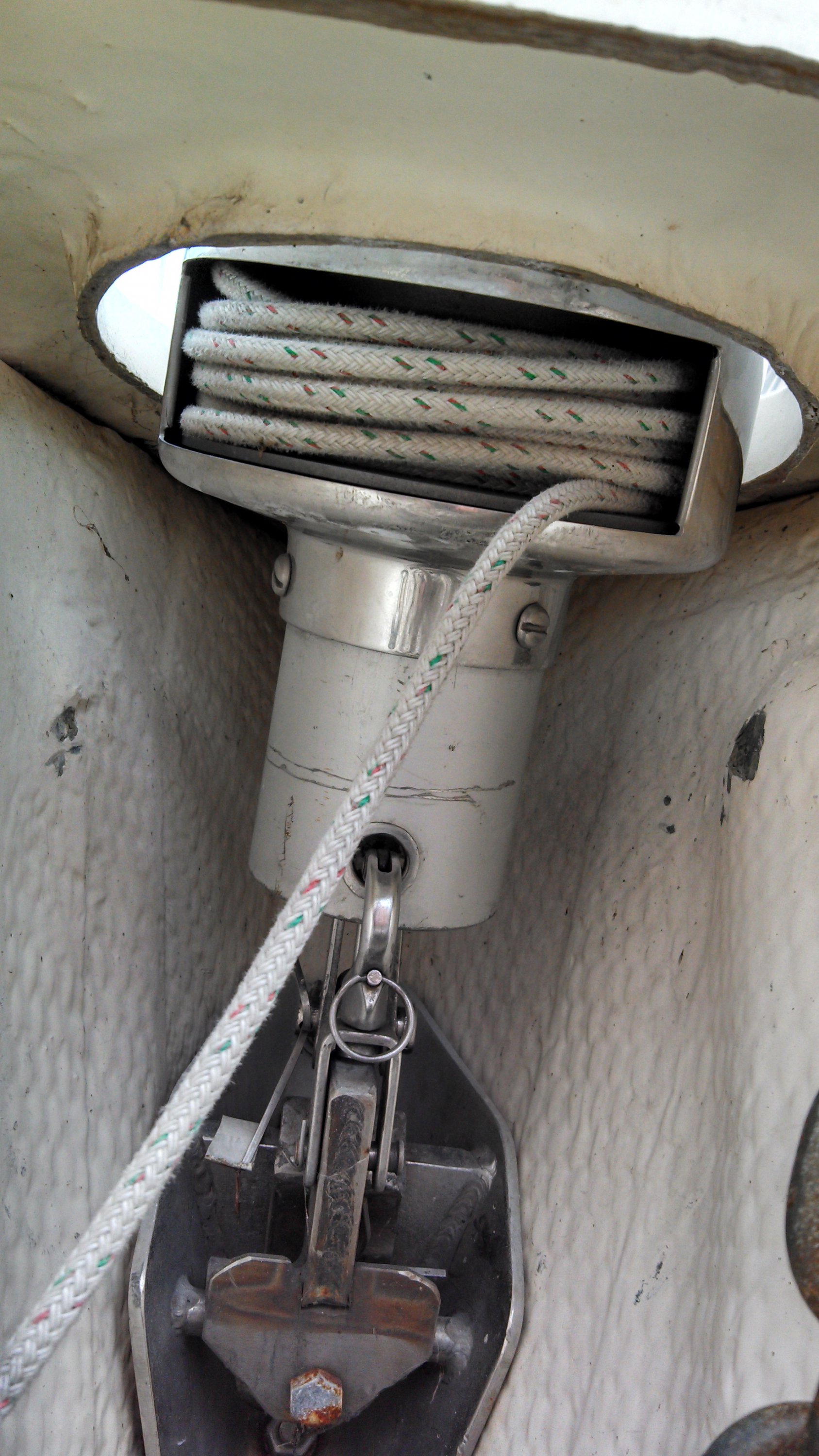

Hi,
I have a 94 37.5 with a Hood RF unit. I don't know what the model number is, but it's shown in the picture (I go back to the survey pictures all the time!). I just took the line off last fall. If it is the same as mine, undo the three nylon screws, and the drum will drop so you can get to the stopper knot. BUT FIRST, draw a line on the lower part of the drum and aluminum tube to mark the orientation of the drum on the tube. There are several holes for the screws on the aluminum tube to let you adjust the rotation of the drum. Be careful, the plastic
screws may be difficult to get out, and access is limited. I broke the back one and had so much fun extracting it.
Dec 18, 2012
168
Hunter 37.5 Annapolis
Correction: The three nylon screws (you can see two in the picture below the drum) hold the drum cover on. That will drop, not the drum itself, and you can access the stopper knot.
Paul

Hi Paul
The picture you've included with the explanation is great, I do appear to have the same model and I send a million thanks for your reply. The unit on My Corona must have been down at some point in time before I bought her because nylon screws are no where in evidence. One screw is missing entirely, a second has been replaced with a stainless steel slot head screw and the third has been replace with a hexhead bolt (what size it is I have no idea). As I indicated in the post I'm changing out the furler line as the old one is shot to the point that it will no longer maintain a position in a cam cleat. Again a millions thanks, the job just got a whole lot less complicated. The Owners Association is worth its weight in gold.
Karl

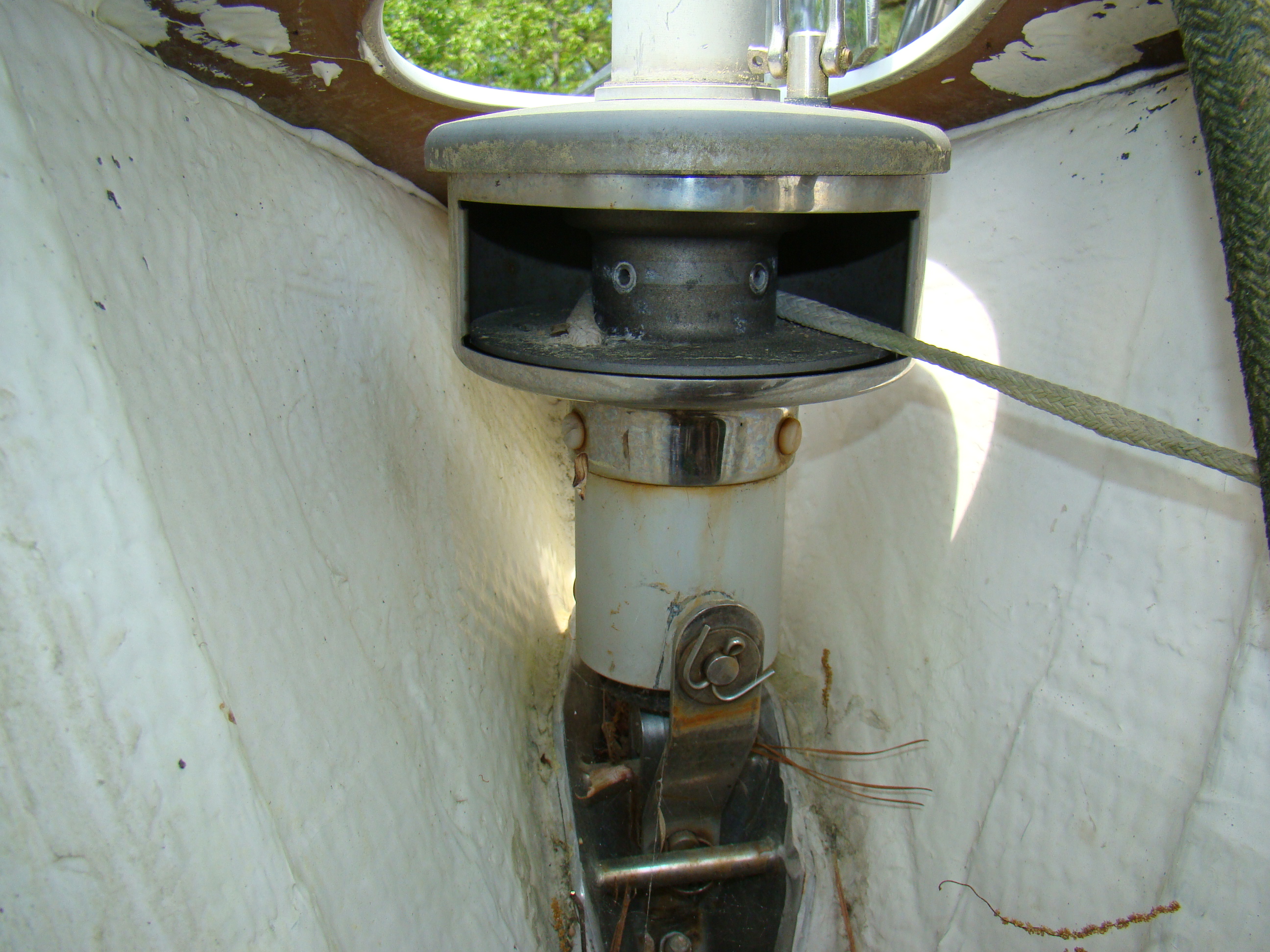

I have the same furler that PAC3142 posted in his reply and I'm having a hard time removing the stainless steel cover to get to the drum. I removed the three screws from around the base, but it doesn't want to drop down. I'm reluctant to try beating on it very hard, but I suspect there is a bit of corrosion between the SS and aluminum. Does anybody have ideas for getting it loose to replace the furling line?

tjar, I had the same issue with my cover after getting all the above advise on model #, etc. I sprayed the unit several times with PB Blaster and then began to tap it top and bottom with a plastic hammer. It eventually moved a bit and I applied more Blaster and tapped it again until it finally broke loose. Since I was replacing the furler line the Blaster mess wasn't and issue. After getting the unit to move, I cleaned up the Blaster and sanded the whole unit with fine paper to remove the pitting and salt residue and then re-assembled with the new line.
