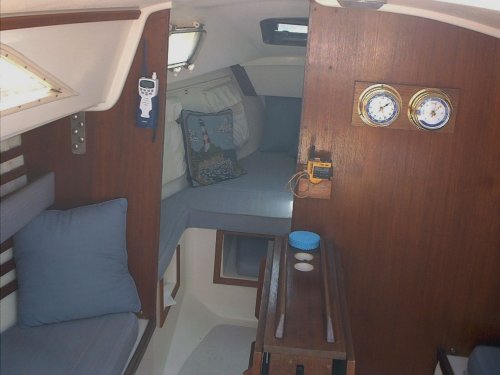

check out the Hunter 22
I have compared my h22 to O Day 25, Catalina 25 and Hunter 25. I think that my h22 has more usable room and more storage space than the for named boats. I have a photo of the interior. I hope it is transmited. Check out the h22.
