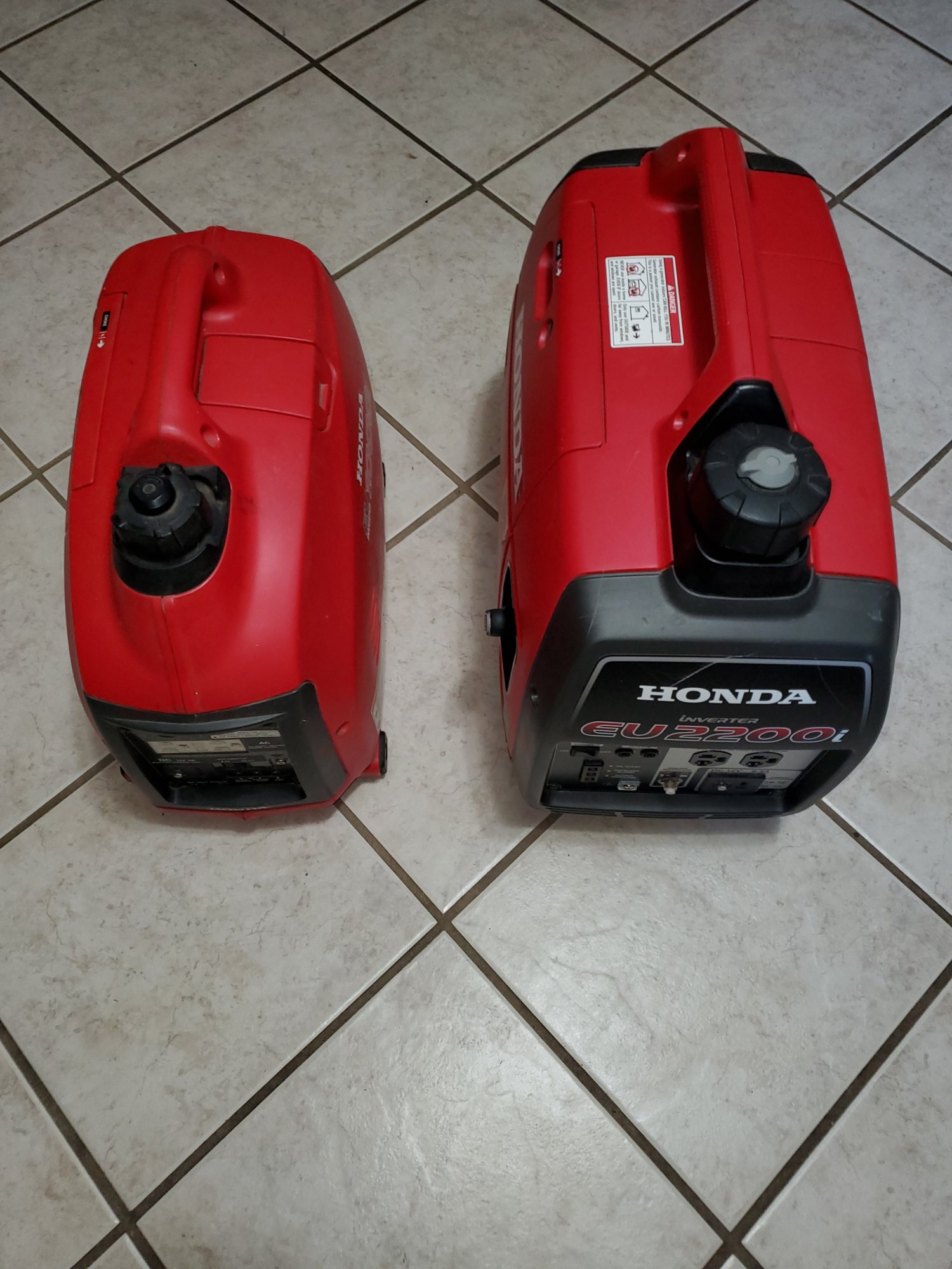

I did a little testing with my generators today. I ran each out of fuel and then added 10oz of fuel. I then timed each generator running approximately a 700 watt load. I used a space heater set on low with a fan blowing on it. This amount of load represents about 60 amps of 12v DC charging. That's more charging load than many of us have but it was the best load that I had handy.
The EU2000i ran for 30 minuets and 3 seconds. *correction EU2200i*
The EU1000i ran for 46 minuets and 7 seconds.
If you had a 60 amp charger and you were in bulk mode you could put 30Ahr back in to your bank with 10oz of fuel using the larger generator.
Using the smaller generator you could return 46Ahr.
Obviously the smaller unit won't run AC, water heater or other large loads, but it should run a battery charger much more efficiently than a larger unit.
I hope someone finds this data useful.

Both were in ECO mode.
The heater did not cycle.
If a generator cannot keep up it will shutdown or trip the output breaker. The Honda will probably shutdown.
I didn't put a tach on them, it never occurred to me. I would assume the smaller one was turning considerably more RPMs. It sounded like it but I wasn't paying much attention to it.
I hope to cruise someday and I know fuel consumption can be an issue, that's why I did this test. I wanted real world numbers.

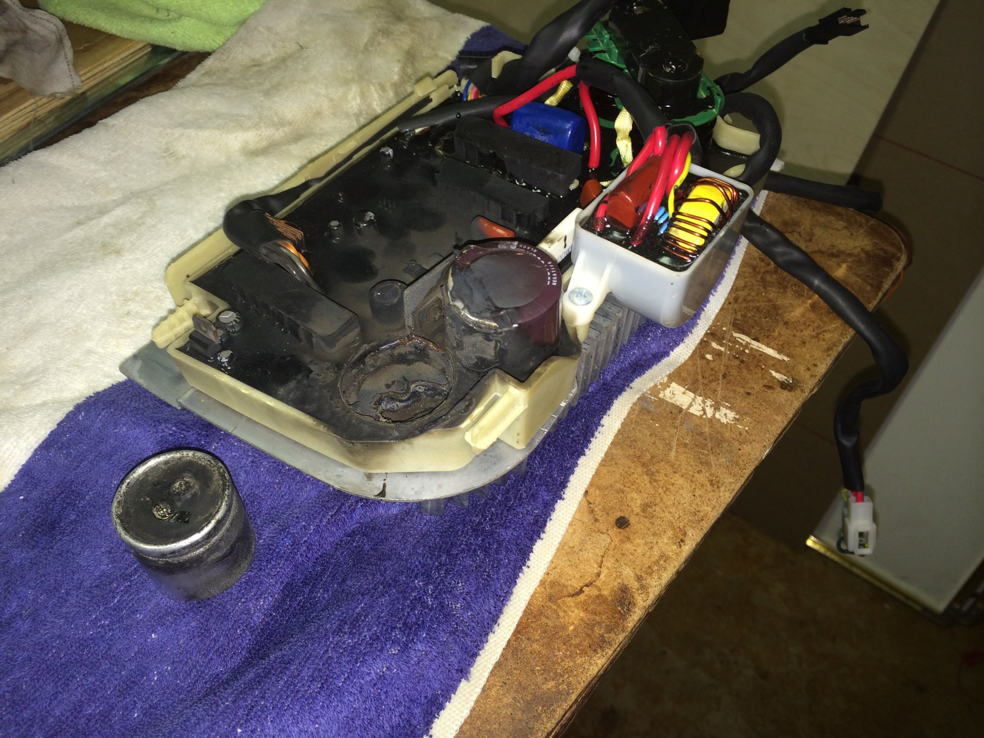

@SycloneDriver : I bought an early Generac iX 2000 back in '09 to get away from Honda's price.. After about 6 hours of run time, one of the big capacitors blew up .. Nice big blue flash! Even though it was out of warranty a couple of years, I called and spoke to their folks, sent pictures and they sent me a complete new generator even though I had asked only for a new inverter board. The new one has run 15 hours or so and is good but louder than the Honda.. yup, I bought a Honda while I was talking to them because I was sure that nothing would come of my conversations with Generac.. I am still happy with it.. Picture is of the problem on the inverter board
