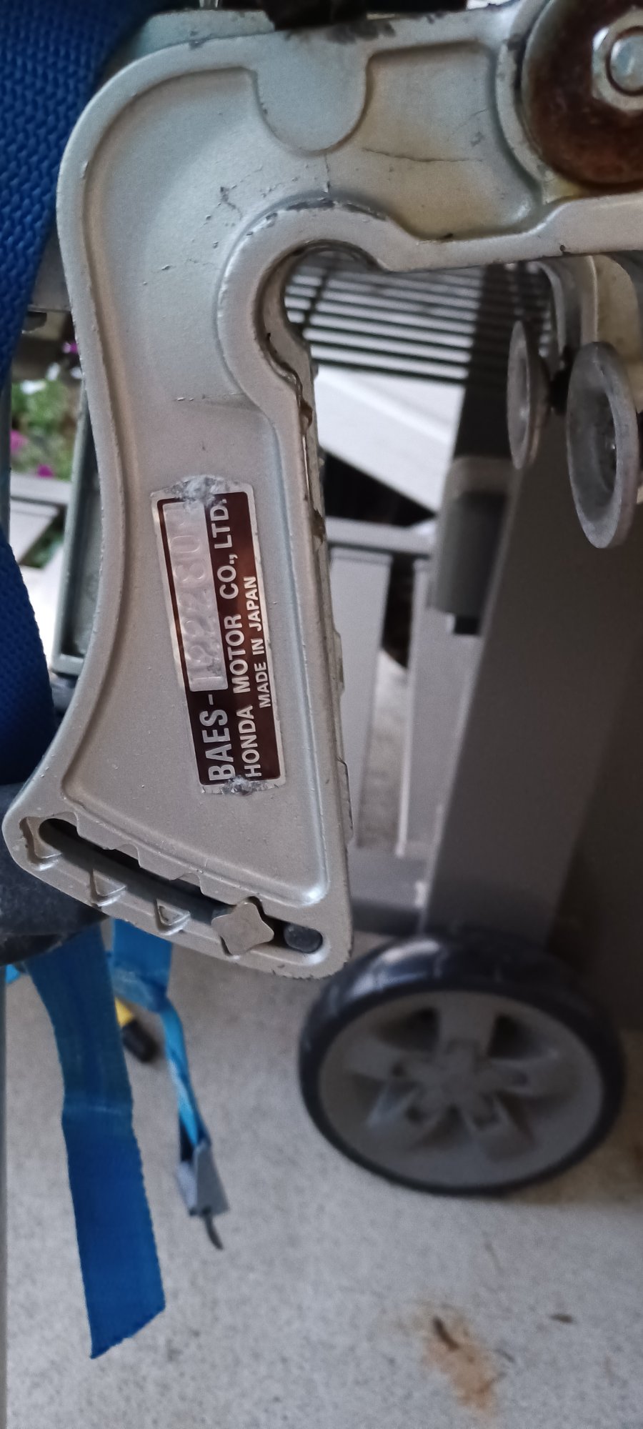

Here is a photo of the serial number plate. the number is BAES 1222809

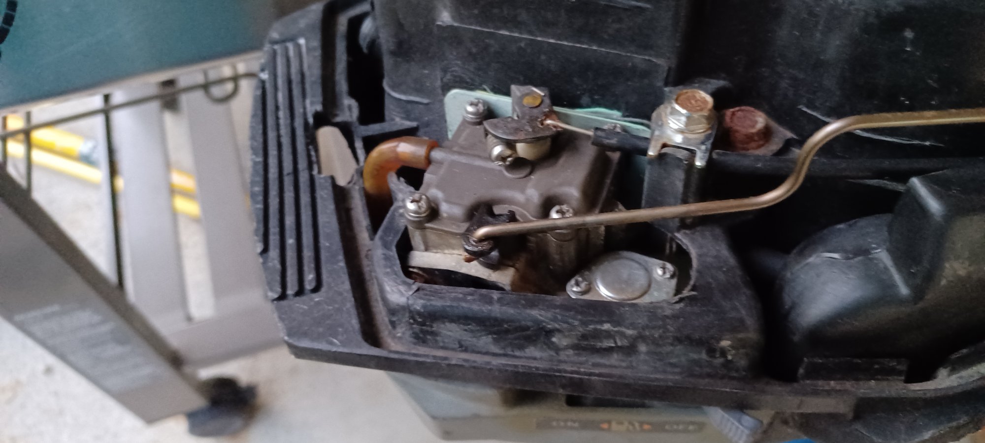

Here is a photo of the carb covered by the housing.

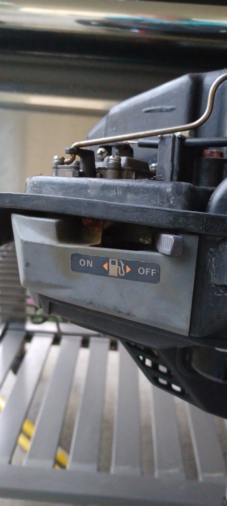

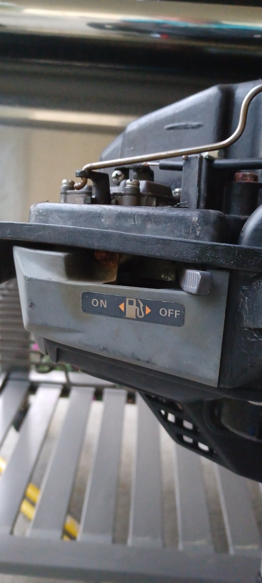

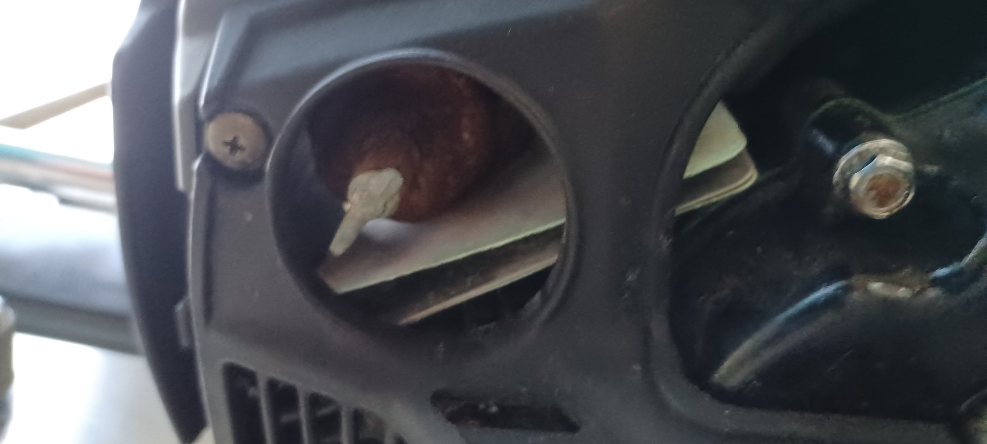

looking from the side. It looks like if the light gray cover below the fuel cutoff was removed, you could get to the carb mounting bolts. The problem is that I cannot see anything that is attaching it to the engine.

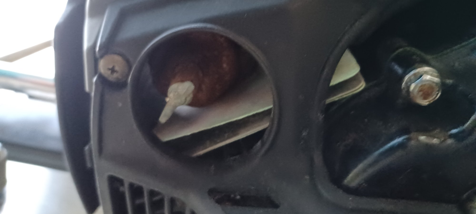

Here is a view looking up at the bottom. I have removed the black guard but the hole above is too small to remove the bowl with the light gray cover above.

I have the same engine. You have to remove the plastic top cover and bottom plastic Piece. You can then get to the carb bolts. When you remove the carb try not to damage the gasket, last time I looked two years ago it was not available. You can buy a new carb still for around $80 if cleaning does not work. Try not to strip out the acorn nuts holding the carb to the motor since that plate is also unavailable. If you can remove the main Jet you can clean out the orifice it screws into. I had lots of rust and build up in mine.

Which bottom plactic piece do you mean. I see a black on that is connected with 4 screws and two machine bolts but removing that does not get to the carb. It does get to a hole in the bottom of the metal lower half housing but it is too small to allow the bowl to drop through.
If you mean the light gray part that has the "on" "off" printed on it, how do you remove it. I removed every screw that was near it and it does not budge. I do not want to break it because I am sure that it is made from pure Unobtainium.

I am certain that it is the main jet, but the problem is that none of the carb mounting bolts are exposed so I cannot figure out how to remove the carb. If could remove the bowl, I would be able to remove the jet but the hole in the bottom of the lower housing is smaller diameter than the bowl. I suspect that the light gray piece that has on/off printed on it needs to be removed but no connections can be found, and it doesn't move.

Sorry for the delay in getting back to you I was at work. Yes you need to remove the lower plastic or metal on the bottom of the motor. It has two small bolts and two phillips head screws holding it on. They may be frozen to the case. One of mine snapped when i removed it. It took mild heat and some beeswax to get out the broken part. They are common 6mm bolts if the break. The plastic part with the fuel on off lever comes off to. Along with the botton plastic that forms a ring around the motor. Then you can access the carb for removal.

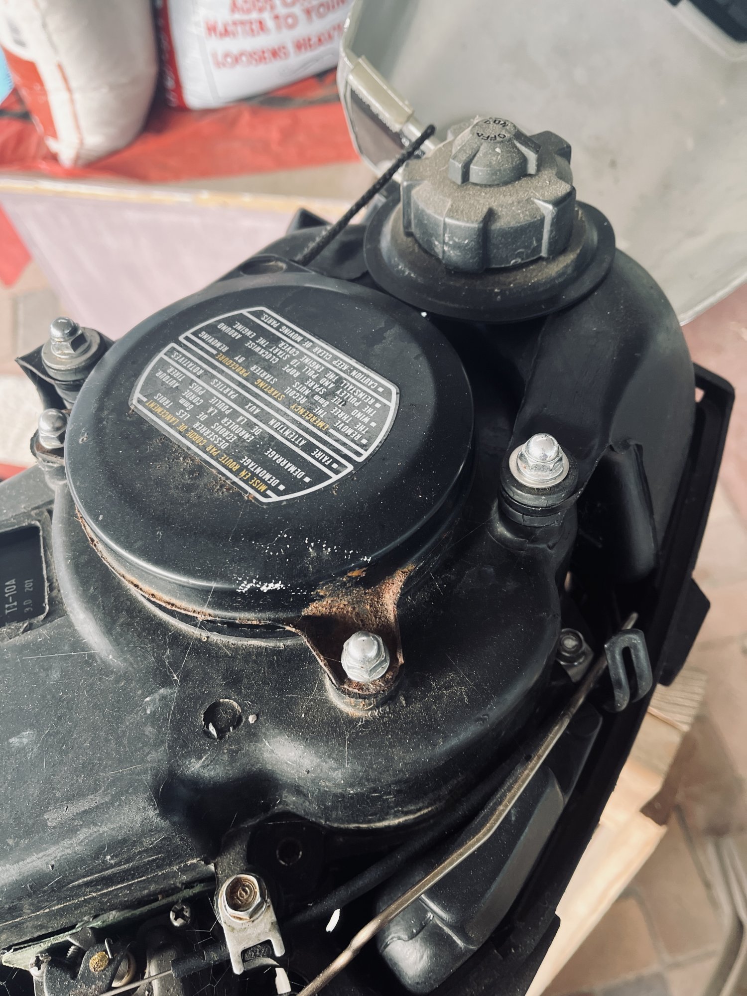

Is part #7 the part that needs to be reomved? Do you need to take off the recoil to get it off? I can't realy tell what holds it on.

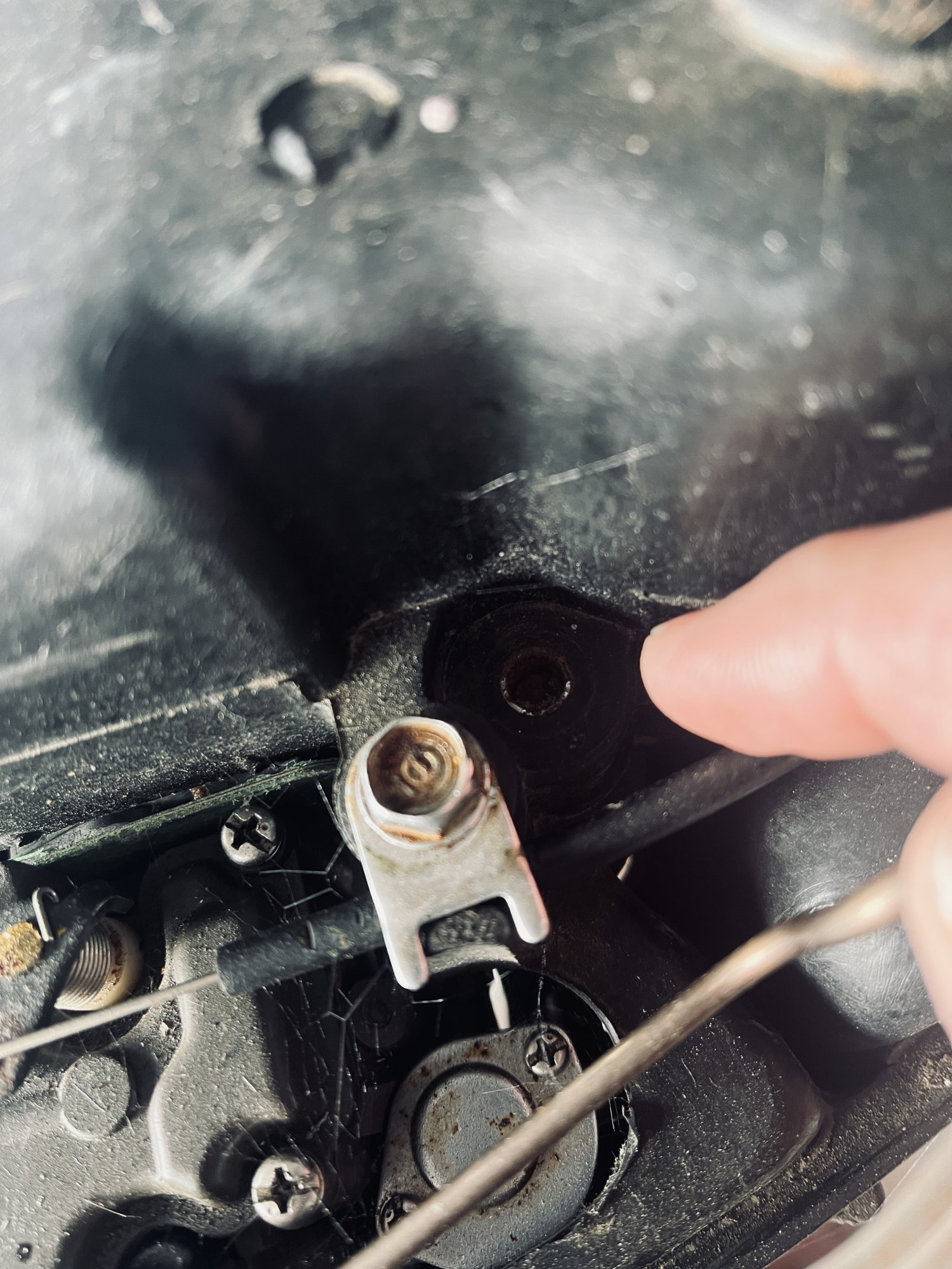

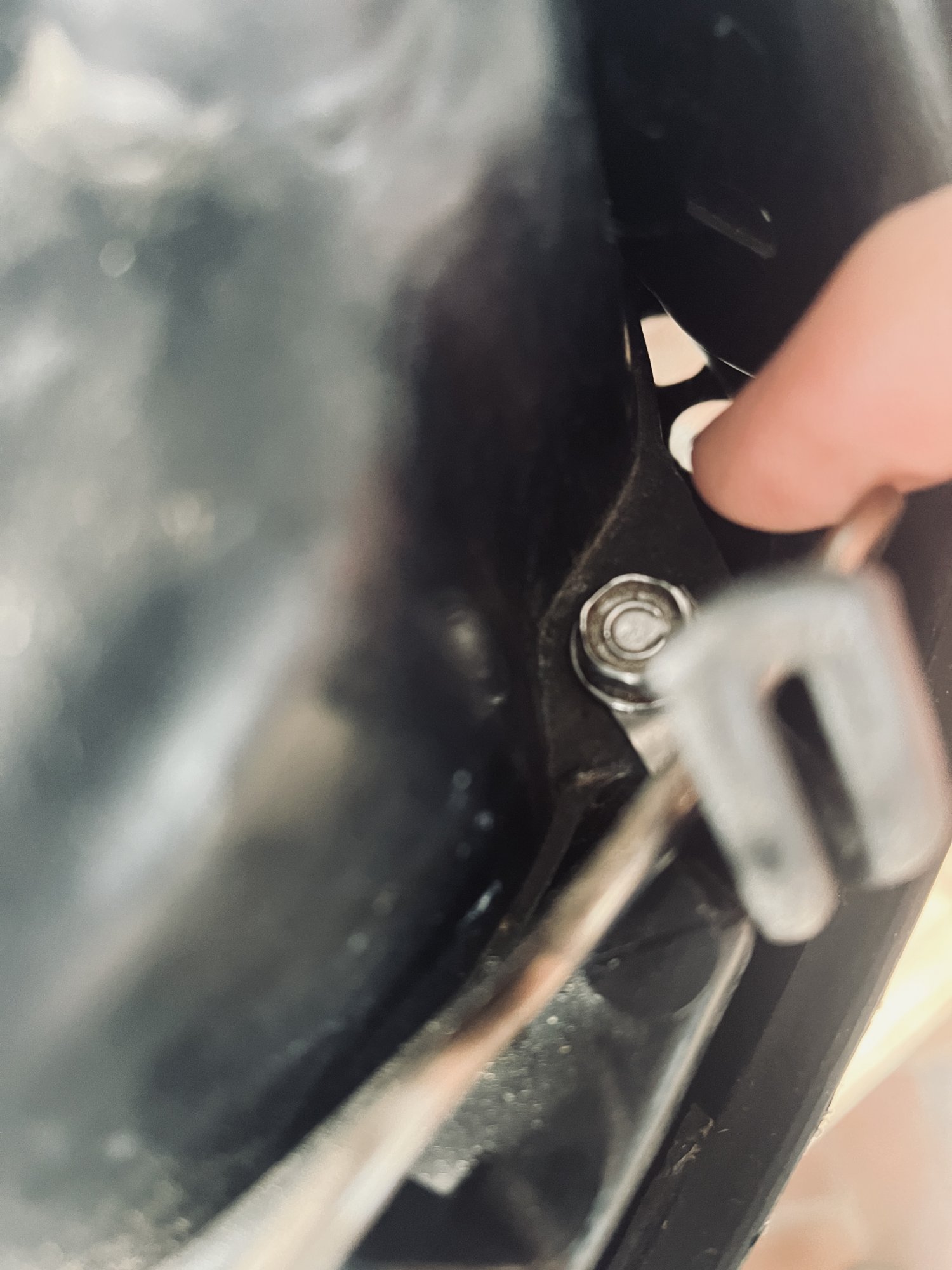

Yes #7 needs to come off the recoil, and fuel tank too. Then remove the two bolts that hold #7 in place. One of my bolt snapped on removal so I only have one. The pics show the bolts to remove. One is just the mounting hole

We have Varoom!
Thanks for the help. Heading to the boat in the morning and only lost one day of my two-week solo criuse.
