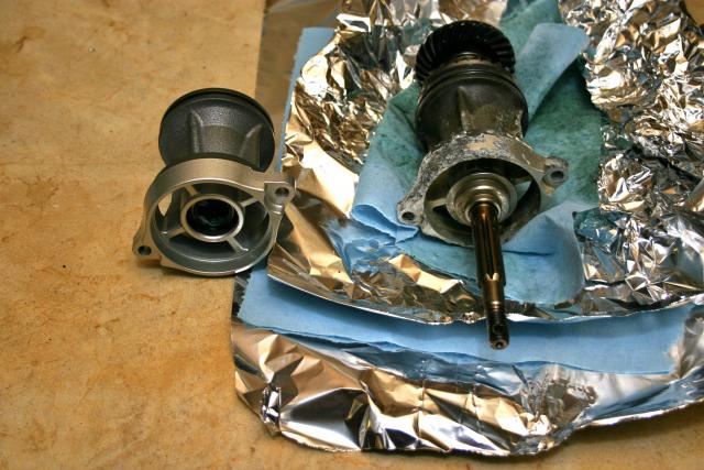

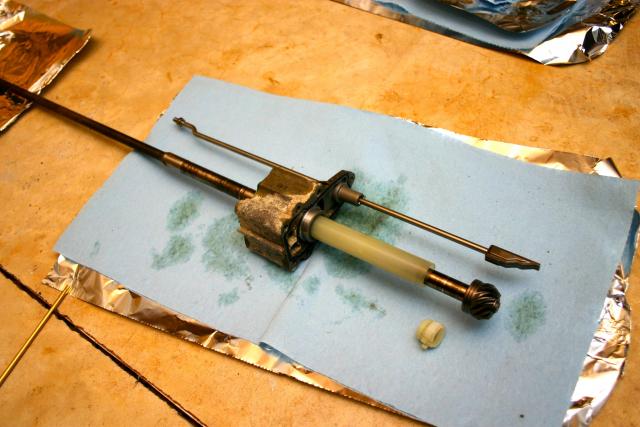

You can probably replace the lower shift rod yourself, there's not much to the lower end. Here's the shift rod and drive shaft assembly from an extra long shaft, don't ask why I had to take it apart :cussing::cry::cussing::doh:
If memory serves you take the prop off, remove the two bolts holding the carrier, and gently pry the carrier away from the lower end body. Once it is out you have to remove the circlip holding the gear at the end of the driveshaft, patience is key... Then you can undo the bolts at the top of the lower end to pull that whole assembly off. Oh yeah - don't forget to drain the oil first...

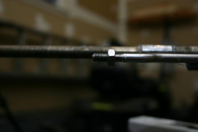

Manny, is the upper rod left hand threads? The Helms official manual sucks. For everybody who's responded, thanks a million. I'm so much wiser due to this forum.

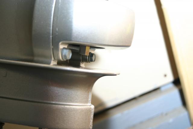

I don't know what the technical term is but the there is a "bolt" on the upper rod that is free spinning. The rod must have be flanged inside the bolt or something similar. I wasn't sure of the thread direction so I posted the picture of the end of the lower rod.

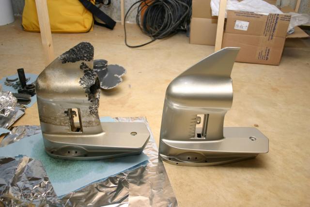

I'm surprised it was so corroded. Do you rinse your motor with fresh water after every use?
Mike,
I'm not surprised that he's got corrosion issues... These are pics of my lower end... after it's second season (next to the replacement parts for comparison). First season in fresh water, second in lightly brackish water. Yes the motor is raised out of the water after use and is flushed with the hose adapter and I also rinse the exterior. My Honda shop couldn't believe it when they saw it and talked to Honda to try and get me replacements under warranty. Honda's response... "It was left in the water".

GOOD GRIEF, only 2 seasons! That's some kinda corrosion issue going on there. I'd guess that the zincs were totally fried and whatever ate them up then quickly went after your lower unit. Galvanic corrosion on that scale is caused by some major action happening on a grand scale. I can see where Honda had some hesitation in covering that as a warranty issue.
I've never seen anything that serious in only 2yrs. My Yamaha 8hp is 6y/o at a saltwater dock for 9mths a year but well rinsed after each use and tilted out of the water, then on the trailer in the shop for 3mths during the broiling season down here and it looks like new.
If your boat's in a marina then there may be a neighbor with serious electrical problems or issues coming from a poorly built/maintained dock electrical system slowly cooking everything near it. Otherwise a shore power or grounding connection might have problems on-board. Hope your new one lasts longer and that you keep fresh zincs on it. Even zincs that look fine can be rendered useless if they have insulated themselves with a powdery layer of corrosion from behind.

Is that a submersion line/watermark close to the top of the water intake?? The Zinc is under the anti-cav plate and it would not have been in the water if that part of the skeg remains in when the motor mount is raised but the motor is not tilted.. Even so, there is something going on in your area with electrolysis.. that is a lot of damage..

If the 9.9 is like my Honda 8, it isn't too hard. I removed the cotter pin and clevis pin holding the top of the shift arm to the shift lever, but did not remove the fitting at the top of the arm - it is hard to reach to unscrew. That let me pull the lower unit down maybe 8 inches, enough to remove the impeller housing. I intend to do it every 2 yrs, and if the impeller looks fine, leave it. Opening the lower unit would help ensure it doesn't get too corroded, making it a bear to eventually remove, even if no new impeller is needed.

Picking up the lower end from the repair shop tomorrow. New shift rod, new water pump housing and impeller and oil change in lower unit...$369..och..but I know parts are probably over $200. Thought about doing the lower rod myself, but read too many horror stories about the rod not coming out. It's a saltwater motor and corrosion is an issue.
Tried to free the connecting nut last weekend and after a lot of Liquid Wrench and heating the part I manage to twist the nut off the upper shift rod. Put the stub in a vice and tried to free the rod stub, but no luck. Corroded in fast. So, ordered an new upper shaft (which is a PAIN to get off without disconnecting a lot of electrics) and while I was at it, a new thermostat. Pulled thermostat off to see if I could detect any blockages. Don't think there are any, but going to do a more thorough examine this weekend.

OK, update. Got the foot reinstalled. And yes, the upper shift rod (Rod A) is a left hand thread. And it's darn picky about adjustment. If anybody ever needs the specs, I've got them in the manual. It's almost impossible to do by eyeballing it. I did use Permatex Anti-seize, so hopefully I won't have the same problem next time I have to remove the foot.
