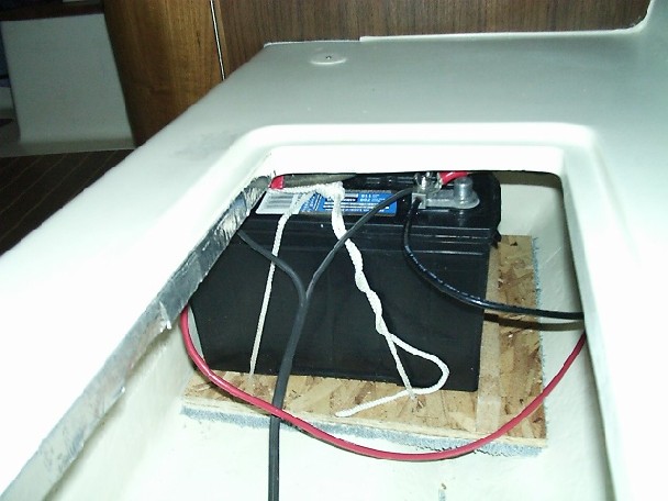

I did the same thing last year. I have the same electric start Honda 9.9 and its starts okay. I would not go any smaller in size. If you have a picture, can you post it? I still have some "dressing up" to do on mine. See attached. You will love the balance it gives the boat. -Nils Anderson

Dear CD & Nils: Thanks for the info! I will go with the #6 wire. I will also post some pictures tomorrow evening. Thanks Again, Bob
