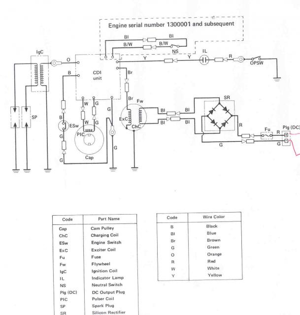

I probably have the same outboard (about 1990 Honda BF8). When I got the motor several years ago, the charging circuit did not work and the problem was a blown rectifier. I think it probably is fairly easy to blow the rectifier and you do this by disconnecting the outboard charging wire from the battery while the outboard is running. Note that you can run the outboard without it being connected to the battery OK (at least on this ouboard) and you can connect the outboard to the battery while its running - just dont disconnect while running.
Once I got my outboard rectifier fixed, it puts out about 2 to 3 amps at my normal "about 1/2 throttle" cruising speed. As far as I know, I have a functional "5 amp" charging circuit so as others have said, even when working, you dont get a whole lot of charging with typical sailboat use and probably need to have alternate ways to keep the battery charged.
Im not sure how you know if your charging is working on not - I have a current/charge monitor which makes is simple - but you could use a current meter (just dont let it get disconnected while running) to measure the current. You "may" be able to see a slight voltage rise in battery voltage when the outboard charger is running.
If your getting no charging from the outboard, first check your wiring between the outboard and the battery. Then make sure the fuse is good (FU in the schematic). If both of these dont result in charging current, you likely have a bad rectifier (shown as "SR" in the attached schematic) - likely caused by the charging system getting disconnected while the outboard was running.
One interesting note about the Honda charging system - there is NO regulator like you will find on a larger boat (also why I attached the schematic). Ie, the small outboard charging system gets no voltage feedback telling the charging system to back off current to the battery when the voltage gets near full (ie, about 13.5 volts). Ive measured mine putting out 18 volts into a load. You would have to try pretty hard but because there is no regulator, you could over charge the batteries and damage them. Im guessing the lack of regulator is common in under 10 hp (or low output current) outboards. Because the current is fairly low, I guess the manufacture didnt see the need to spend the money on a regulator.

Sort of interesting and someone can correct me if wrong (could be...)
But based on the schematic I just previously posted, if the fuse fails while the engine is running, it is equivalent to disconnecting the outboard charging wires from the battery.
What happens is that the coil is "energiized" as the engine is running. When the battery load is disconnected, the current immediatly goes to zero and the energized coil creates a big voltage spike. This causes a reverse bias breakdown in the rectifier and damages it.
If the fuse were instead placed between the coil and the rectifier, the rectifier would be isolated from the coil if the fuse blew. The coil would still create a high voltage which might spark somewhere - but likely no damage. But with the fuse after the rectifier (like in the Honda schematic), seems to me the fuse blowing could also result in the rectifier getting damaged...

If your rectifier is fried, you could add an external rectifier. Even a cheap radio shack rectifier with a 400 volt PIV and a heat sink attached (really does not get that warm at 5 amps, but cheap insurance) will only set you back $10 or so. On my mid 80's vintage Honda, I unplugged the regulator, connected those two plugs together in the engine compartment, used the same wire and placed the rectifier between the engine and the battery. It can withstand the plug removal with engine running, although I wouldn't make a regular practice of it unless you install a capacitor and maybe a 15 volt zener diode to shunt away the spike. Just remember to have a dedicated connection, because attaching that wire directly to the battery will FRY the windings in the alternator and let out the magic smoke.
Godd Luck!
walt
Jun 1, 2007
3,550
Flynfol, I actually did the same thing on my old Honda BF8 - bypassed the stock rectifier (probably would have been expensive and I dont like that its susceptable to being blown so easilly) and made an external rectifier which is mounted on a heat sink (some aluminum angle) in the Laz area of boat.
The bridge rectifier I picked up is 400 volt reverse voltage 35A forward current (MB354W - BP) and is maybe overkill - I think I paid less than $5 for it from Mouser. I also added a 100 uf 100 volt E cap accross the rectifier DC side and this is enough to "dampen" the alternator coil from producting a big damaging voltage spike when everything is disconnected from the battery. When I first put this in, I disconnected and connected the altenator wires from the battery over 100 times with the outboard running at various rpms (also watching with a scope) - didnt even come close to damaging anything.
The alternator output voltage when it has no battery load (ie, open circuit) can be fairly high - I think I saw over 40 volts (rectified with the cap). I dont think any sort of zener or transorb is necessary with the 100 uf cap but if you did put one in, It probably should be somewhere over 50 volts because you still want the system to work without the outboard connected to the battery. The problem then is that at 50 volts breakdown, it doesnt take much current to blow up the protection diode so you may have created a new problem. But its not needed regardless if the capacitor is large enough.
