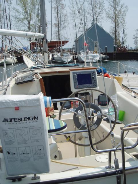

have been thinking about making a pod just these last few days. No pics, but here's my idea. Round: A 4" or 6" plastic pipe cover. They're durable, white and adaptable. Another thought: Plastic electrical boxes (waterproof/ no holes); square, easy to mount but they may need paint or gel coat.
When I am done I'll post photos.

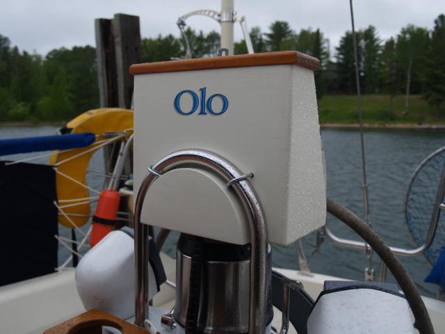

I made mine from marine plywood that I then painted with epoxy and porch paint. I had just finished building my stitch and glue dinghy and felt pretty confident. I have to say that I love the look of it. After two seasons it still looks as good as the day I installed it. If you're carefull when you build it, it can be quite waterproof.

Homemade Navpod.
Mine cost $8.00 at Lowes including end caps. And I still have 6' of material left. Two 2 x 2s fit perfectly in the top and bottom sections for holding the screws. Plenty of room for the wire in the center section. Seven years and still white and shiny.

nice box! but how do see the compass?

how does the backside look for connections ed?
and danny, that looks really nice.

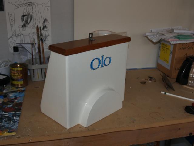

Danny that is a very clever half moon on the back.

I knew someone out there would notice that I impaired my sightline to the compass, but it's not actually as bad as it looks. I do have to croutch a little to get full view but I don't feel that I'm sacrificing too much. Thanks for the compliments all. I have to say that if I were to add up my hours building all of the things I've made for our boat, my hourly rate versus going out and buying a stock item would be pretty poor. I'm not alone here because I've seen many great projects here, but it sure does give our boats character and it makes them feel more "ours".

For Hermit. Having the taller and offset helm guard makes all the difference. TIQ made that one for $100. For AJ. The back is solid, nothing comes out the back. The wiring comes out the bottom near the port side of the helm guard(son at helm).

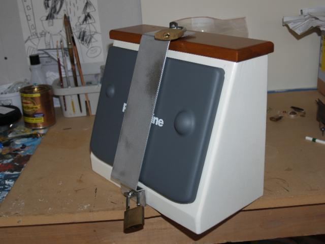

Hermit, that half moon on the back allowed me to use the existing pedestal guard which is the same height as yours. I second Ed's comment about the offset and taller guard making it quite a bit easier to mount the electronics, but since I wasn't going to spend the money on the navpod, I certainly wasn't going to get the new pedestal guard, call me cheap.
Speaking of cheap, I bought my C80 display on ebay and after the transaction, I concluded that it was probably stolen. With that in mind, if you look in my photos, I added a theft deterent. It's not Fort Knox, but it may be just enough to make a thief find another, easier target. Something to think about when building your own.

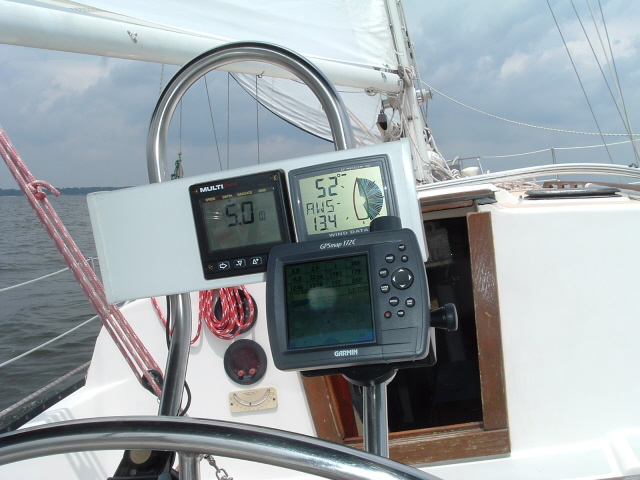

Jan 2, 2008
547
Hunter 33 (Cherubini design Forked River, Barnegat Bay, NJ
All the instruments I need behind the wheel. Tilts and swivels so I can see it from any position.
