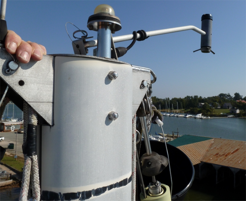

Good question, I've wondered that myself. I've always used the most forward hole. Don't see how the aft hole on the headboard would effect the sail shape, but I'm by no means a sail shaping expert.
I've attached a pic that I took whilst at the mast top, I can see how the halyard placement on the headboard would effect the line of force based on sheave position. In this case the load is from the bosun's chair...but definitely very close to the mast.
