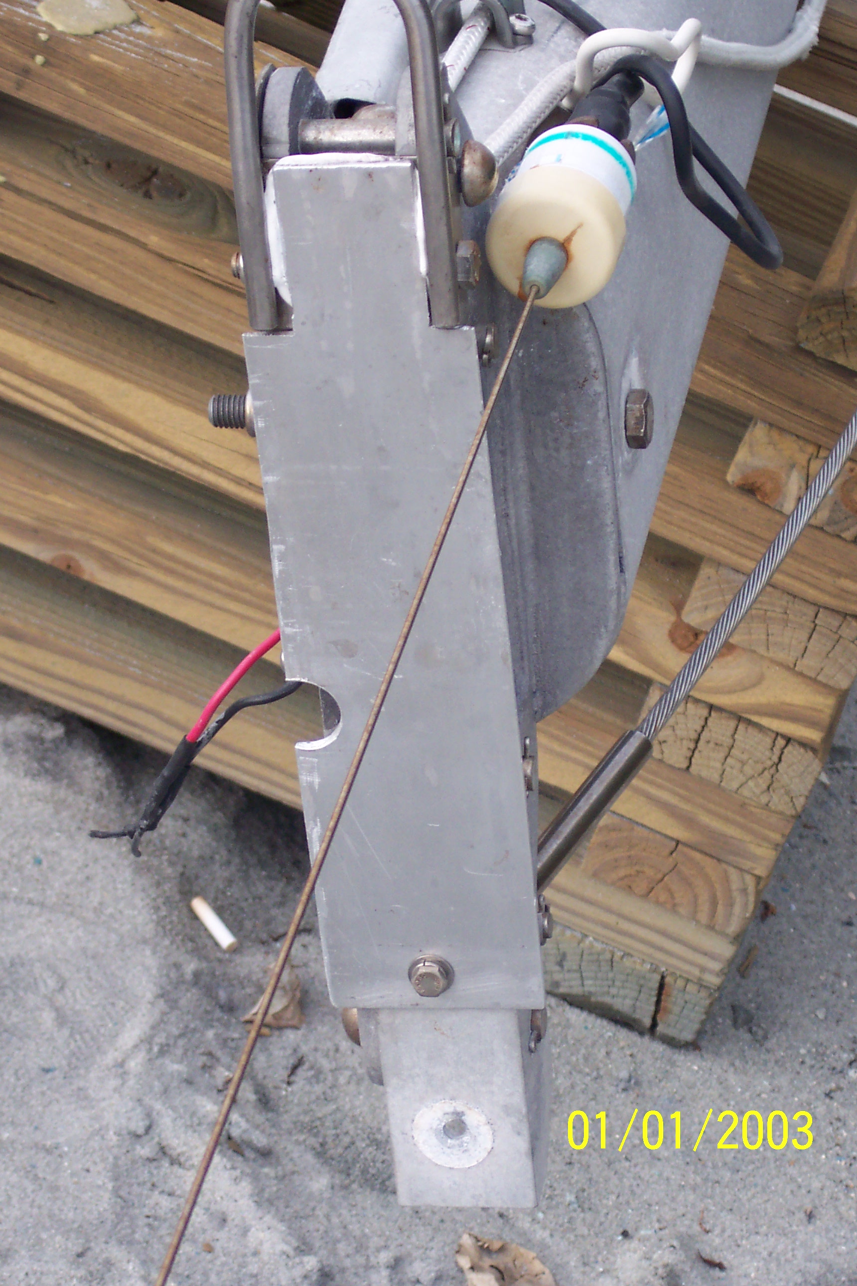

I'll probably take some hits for saying this but, I added opposing 3" vents in my mast.
Along the bottom edge, I used a 1/4" drill bit & hogged out notches to allow any sitting water to drain out.
I had the mast stepped & repaired the deck sag. There was little or no seal for the wire penetrations & the mast step bolts. This along with an open mast top crane (when it rained led to soaking my plywood coring.
Most of the mast's structural strength comes from the rounded front & rear shape & not the flat sides. To lessen rainwater coming in from the top I added a cover plate. There are still openings up top for venting. Now with the two vents, I have a cooling tower effect. Because of different air pressure across the mast top, air is sucked thru the vents & out the top along with moisture from any standing water at the base.
Here are some pics:

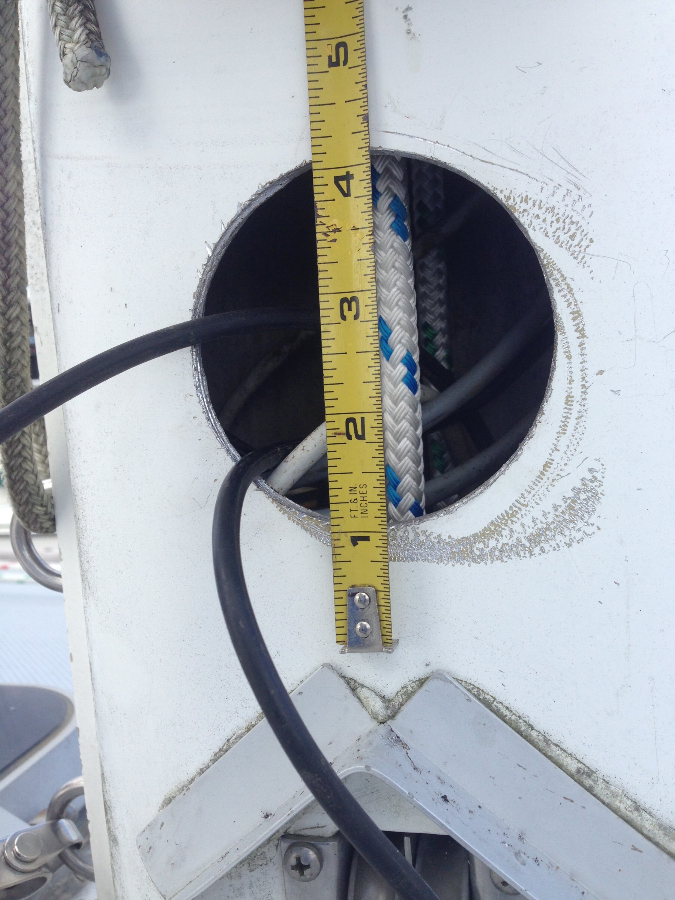

I added an access hole. Used a hole saw and then machined a cover plate and four 1/4 -20 flat head screws tapped into mast. I can get my hand just through the hole. Easy to pull out wiring and plug. Second picture you can see the cover plate at the bottom of the mast

Two holes with a hole saw and then the vertical edges with a jig saw.
