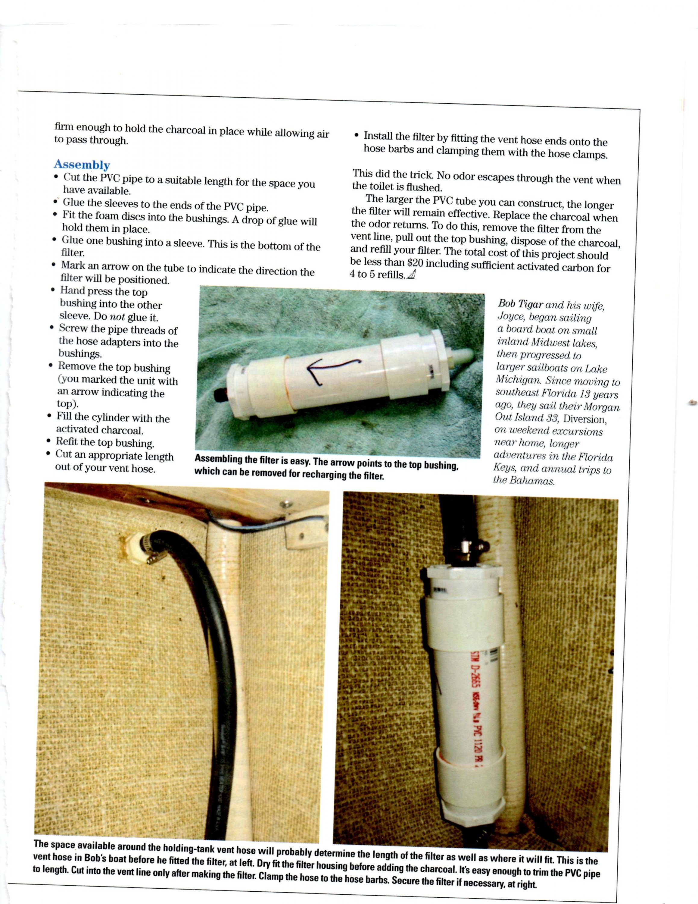

I can show you how to build one for less than $10.00 using a few pieces of pvc and activated charcoal. When mine stops working, I take it apart and refill with more charcoal. Had the same one for 6 years. Charcoal costs $6-$7 and will refill it 3-4 times. Funny, Peggy (in an old quote) thought these thins would stop the vent from venting. Found the article published in Sept/2011 GOB. Its attached. Bob

Big Orange sells a direct replacement for the Sealand and it's designed to take apart and recharge as required.
They sell recharge kits but all you need is a box of pellet type charcoal from the aquarium store.
Well made with a bypass valve and molded in brass anchors for the screws.
While it does suffer from the same problem if water (or worse) enters it, replacing the charcoal only takes 5 minutes and about 5 bucks.
While I did increase the vent hose size, use the recommended chemicals and empty the tank weekly - I still had the ocasional bad smell from the vent. Adding the filter to the mix kept everyone happy (hey, it's a compromise - like sailing).
I haven't changed my mind about 'em. The SeaLand or any other vent filter can most definitely block the vent (which will most definitely stop the venting) if it gets wet. That not only makes 'em inadvisable on most sailboats, but also makes it impossible to backflush the vent line to prevent blockages. It costs almost nothing to modify the vent to create the aerobic environment in the tank needed to prevent odor from being generated and you only have to do it once.
