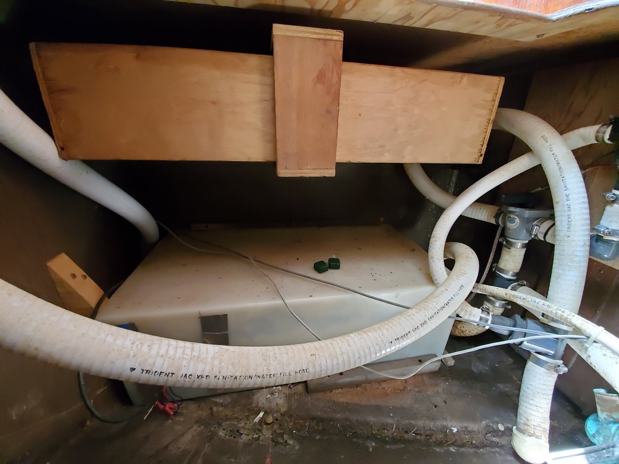

Does anyone know where I can get Raritan SaniFlex hose in Canada? The only place I can find is Marine Outfittersand they want $27.99/ft!!?! My local store has Trident 101 for $11.99/ft or Shields 101 for $9.20/ft. I have a fair bit if room so I don't really need the flexibility, I may just go with the Trident 101. I just thought the SaniFlex would be easier to install but for a few hundred bucks . There is currently smelly old Trident VAC XHD, yes, it smells bad in there.
This is the mess I need to get rid of. The hose on the upper left comes from the head then up to a vented loop :facepalm: then to the tank. On the right there is a macerator and a hand pump for pumping out the tank, neither of which are connected to the thru hull since I'm inland. I'm going to chuck it all, go straight from the head to the tank and then straight from the tank to the pump out fitting. The vent hose needs to be replaced as well.

No matter what hose you use, it will start smelling again. This mess is a great candidate for replacing hoses with pvc tubing. Use 1 1/4" pvc and rubber connections between tank and tube.

Yes, the border is closed right now. I have had deliveries to a place in Ogdensburg which is about an hour from here. It saves a lot in shipping and brokerage fees. I was hoping to get that job done soon but could wait another month. The Defender price is very good.
