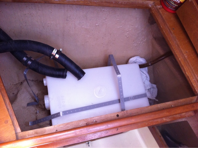

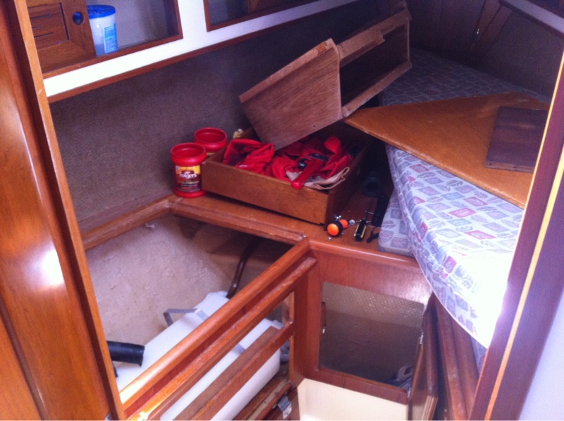

Oct 9, 2008
1,742
Bristol 29.9 Dana Point
Hi Peggy.
Just to show the restrictions and why had to go with 5g tank. (Pics)
The wood box assembly on the Vberth is the support for the top pull-out drawer. It goes on top of the tank. The hoses connect on the left (aft)there. So only tiny bit more room forward, and to port if had a custom wedge shaped tank. It's actually less room than it looks.
Would have been giant pain and added expense for little increase.
