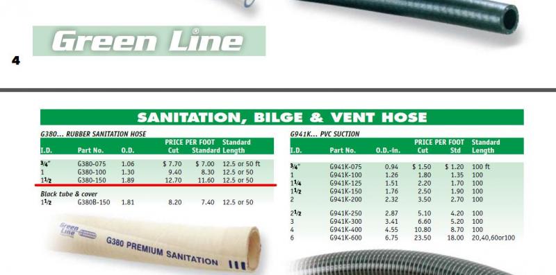

Shortly after getting our 1999 H310 in 1998, I made a small change in the suction hose from the holding tank which required the installation of about 18" of new hose. At that time I went with Greenline G380 Premium Sanitation hose as it was available from an industrial supplier which I occassionally used. Greenline is a big name in industrial hose but I knew nothing about sanitation hose at that time.
I removed the short section after twelve years without a trace of odour on the outside and the inside wasn't too bad after it was rinsed out.
I would suspect that all the big name hoses are the same quality. And quite likely, exactly the same materials and construction. I think it's the lesser known brands you have to be careful of.
