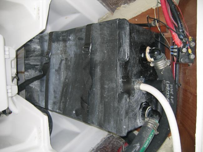

Greetings folks, this is my first post. Too bad its on this topic. I just bought a 2003 Beneteau 411 Special Edition. Little did I know the boat suffered a catastrophic failure of the forward holding tank causing the contents to empty into the forward hold under the shower floor. This all happened recently under the previous owner and the surveyor didn't find it! Needless to say I was not amused to find this situation when I took posession of the boat 3 weeks ago. The failure was caused when a pumpout was attempted with a clogged vent hose. The tank collapsed and the elbow fitting leading to the macerator hose failed. The previous owner clearly tried to repair the fitting with some kind of white goop, probably silicone caulk. I pulled the tank, turned the macerator into a makeshift wet vac using some clear 3/4" hose and some pvc pipe from Home Depot, and suctioned out the hold while flooding with vinegar and water. I was a nasty mess! I think I've gotten most of it out. My question is about the tank itself. At this point I don't trust it. Its the black tank supplied by Beneteau with the boat and it looks CHEAP! I've reinstalled it for now with new fittings dry fit with teflon tape, but I would like to replace the tank. I've looked at Ronco Plastics in So Cal. They have a lot of tanks, but no exact fit. The tank is 19.5" tall, 13"x14" on top with the 13" dimension tapering down to 11.5" along the starboard side. Does anyone know where I can get a replacement tank for this boat without buying the cheap OEM black tank? Photo is attached. the photo is sideways. Sorry. Thanks for any help you can provide. Dan Berkey S/V Corvette

Why does it need to be a perfect fit?
Dan: Why does it need to be a perfect fit. It looks like you have plenty of room to fit a new tank of a similar size!

Steve, It doesn't necessarily have to be a perfect fit, but I've calculated the volume of the existing tank at almost exactly 13 gallons. The best fit I can get from Ronco is 11.4 gallons. 13 gallons is small enough. I really don't want to lose another 1.6 gallons. Dan

Yes. I'm waiting to hear back from them now. I'm hopeful they'll tell me they saw the error of their holding tank ways and have replaced that cheap black tank with a proper white tank with 1/4" walls. This one has 1/8" walls at best.

I wouldn't trust a tank that's been through that either. And, after looking at your photo, I don't see any reason why you'd need an identical replacement, 'cuz you have a LOT of room for a larger tank if it's the right shape (and I'd bet real money that Ronco has one...you just need to know how to orient it to take advantage of it)...or even why it has to go back into that same space if there's another space within 6' of the toilet that larger tank will fit. If you'd like some help with this, send me an email...I'm in all the owner directories. And I wouldn't be too sure that surveyor missed it...'cuz from what you've described I have a STRONG feeling that it happened after the survey...when the PO tried to pump out the tank the last time before you took the boat. And the only way a surveyor would know that the vent was blocked would have been by trying to pump out during the survey.
