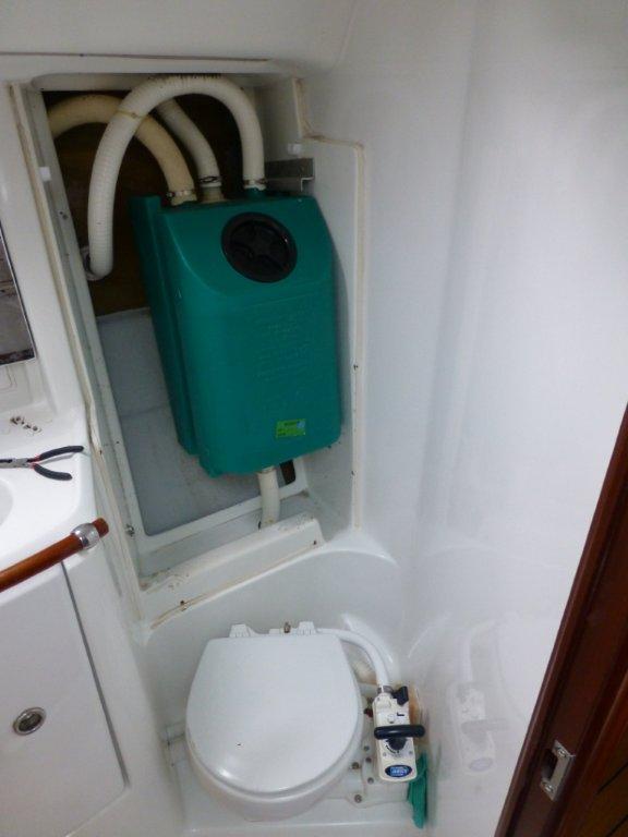

The 361 holding tank mounted above and behind the head on wall. It has a plastic cover for it to make it look nicer. The Y diverter was under the sink near the seacock. The tank fill went over the top, and the deck drain was also on top via a dip tube.
They say a picture is equivalent to 1000 words!! This is a picture of the Beneteau 361 holding tank after you remove the cover in front of it.
Nov 8, 2010
11,386
Yea. Like that! Glad my memory still works.

Fine picture. When I compare it to this drawing:
http://www.ronco-plastics.com/newRonco/installation.php
where there is a hose for in, out and ventilation.
What is the 4. th hose in the picture for?
Guess you use the old hole in the hull for emptying the tank off shore. How do you empty it into another tank in the harbour?
Thanks all for your help.
The tank in the boat has TWO exits, a dip tube on the top going to the deck fitting, and a exit to the sea on the bottom.
In the harbor your only choice is to get pumped out via the deck fitting. I assume that is what you were asking.

FWIW, on my B323 the bottom tube goes to the deck fitting. I do not have a macerator, though.
I am not going to install a macerator, but would like a Thai style hose and then avoid throwing paper in the toilet.
Hose for in.
Hose for ventilation.
Hose for out (bottom).
Hose going to the deck (I only use it to flash the holding tank; I guess with proper facilities at the dock you could use that to empty the tank too).
