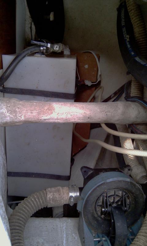

Do you know how the original tank was secured/strapped into the boat?

I only know on mine the tank is located in the stern and has two nylon straps in place. See attached.
