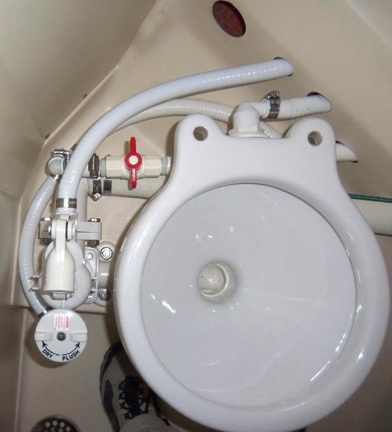

Here is my system after changing from a Jabsco To a Raritan PH ll Superflush.
The red valve has the option of sucking potable water straight from the sink while the sea-water suction is closed and clears the head discharge line of sewage and seawater organisms. All this courtesy of a delightful young lady by the name of @Peggie Hall HeadMistress who is our resident sewage treatment specialist.
If you really want to go hog-wild for something to build during the cold winter months, you could even lead the fresh water discharge from the head pump to your drain lines and maybe even get a few extra years out of them. It might be something like operating a petroleum refinery when you visit the head with opening and closing of valves everywhere but as I said, it may give you a few extra years. Mind you, with the latest generation of sanitation hoses, probably not worth the effort to rinse your drain lines. Check the archives for info on the fresh water flushing system. Well worth it if you've already got the system in pieces.

Ralph...Don't blame me for the over-complicated plumbing nightmare shown in your photo. It doesn't even begin to resemble anything I'd ever recommended doing.
